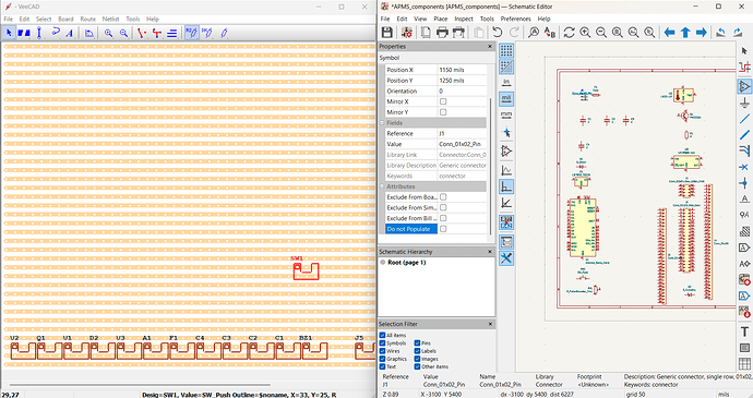

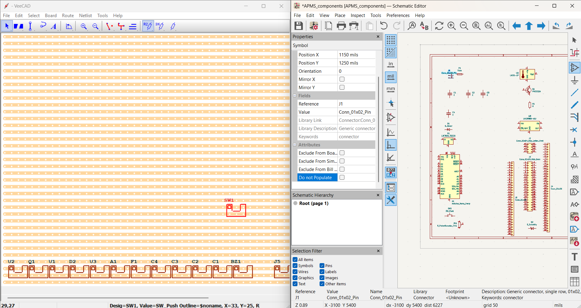

KiCad v9.0.3.
VeeCAD v2.45
I’m trying to use VeeCAD for stripboard layout and want to bring in all my components from KiCad. I’ve created a “parts bin” schematic in KiCad 7 with all my usual components (resistors, capacitors, diodes, transistors, modules, etc.), leaving them unconnected.
The problem is:
  • VeeCAD will only open netlists exported as OrCAD PCB2, not KiCad’s legacy netlist.
  • When I export as OrCAD PCB2, all components appear identical in VeeCAD — the footprint/package information is lost.
I am ideally trying to:
  • Recognize different component types (resistor, capacitor, transistor, IC, etc.)
  • Preserve some “footprint” info so parts aren’t all identical in VeeCAD
Can anyone help explain what I’m doing wrong/how to fix?
Thank you

Can you post an example netlist you have exported from KiCad?
@craftyjon this is the netlist that it produces as opened in notepad:
( { EESchema Netlist Version 1.1 created  2025-08-16T15:19:24+0200 }
