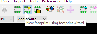

There is a footprint wizard (if enabled on your platform) that can help with creating such footprints. (In the top toolbar with tool text similar to “new from wizard” I can not check this as they are disabled on the platforms i have available right now)
Here is a screenshot of what I have for new from wizard:
Note, this doesn’t show in the menus.

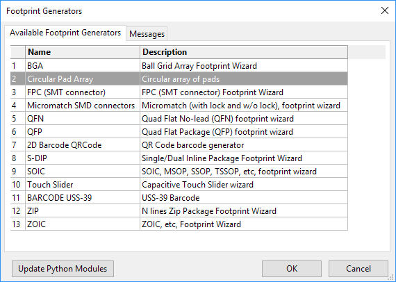

Here is the list of footprint wizards available to me on my install:
And for the OP here is what the circular wizard looks like:
