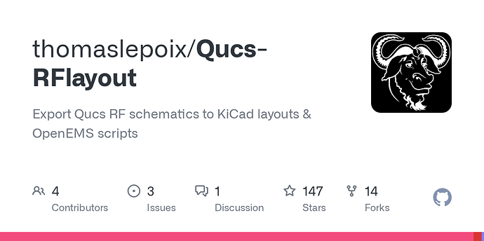

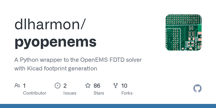

you may have a look at:
or
do you have a repo to access to your script? … I think it could be useful for other RF guys.
It would be even integrated as kicad pcbnew plugin.
Unfortunately the two items you linked are more on the simulation side of things. I’ve used qucs-rflayout but it would not really fulfill my use case. I already have a simulated circuit that works so rewriting the physical model to fit one of these tools is redundant work. As per StepUp, even when I remove all the lines you indicated making it a single enclosed shape I still got the same error. You are correct though, the dxf needs some touch-up before it is exactly what I want.
