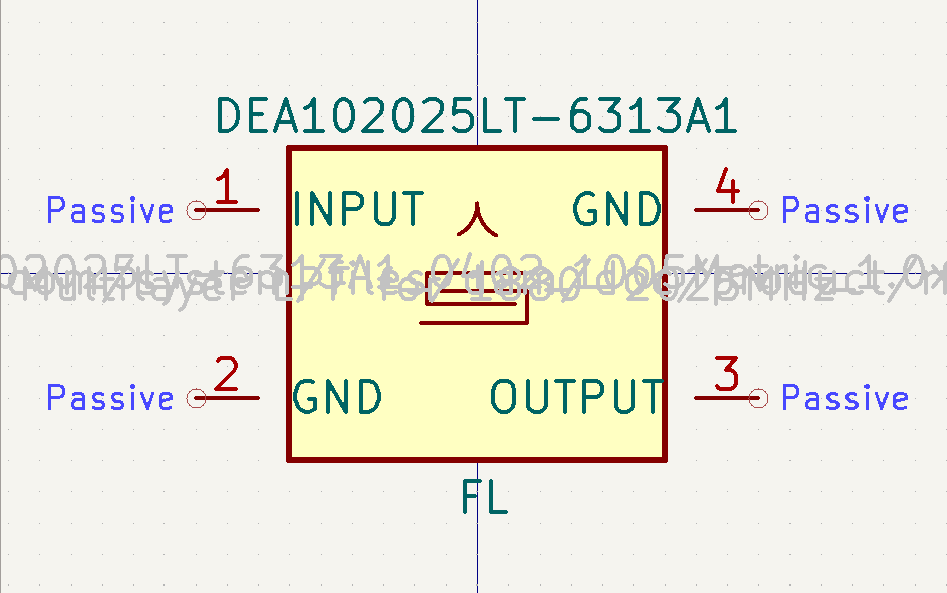

I created a symbol. It seems that symbols created locally on a machine are stored in one file for example xyz.Kicad_sym. It appears that all symbols created in a project are stored in a library which is like xyz.Kicad_sym. For example I created a symbol in the library Filter. Do I have to edit Filter.Kicad_sym file to include new symbols by editing it? How does this work?
When submitting a merge request to put symbols I made into into KiCad libraries, is it necessary to attach the symbol file which contains this symbol and others. I looked at merge requests in KiCad repo in this link:
There seem no attachments with each merge request. Does the KiCad repository detect the change in a symbol library automatically when doing a merge. An example of this is putting new symbols in Filter.kicad_sym file and doing a merge after that with necessary git commands.
Here is the symbol:
Footprints are not created for all newly created symbols yet. How to make footprints blank? Is it okay to leave the footprint link as blank on the symbol or delete it?
Please explain.

My question was, how to merge newly created schematic symbols into Kicad libraries. I have created a few symbols and want to merge them. Right now they are in a file called Low_pass_filter.kicad_sym in a local KiCad template project folder for small symbols. Do I have to edit the Filter.kicad_sym file and put them into it and merge the edited Filter.kicad_sym file? This is after checking out a file with git . After modifying Filter.kicad_sym, it has to be committed with git and merged into Kicad libraries particularly
Is this how it is done?
