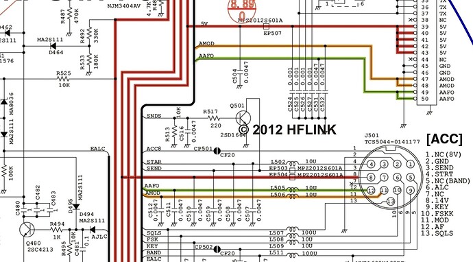

In some electrical diagrams, it can be useful to draw a colored path over one or more nets. This path does not interact with the net table, but is only intended to help the reader understand the path of a signal (a typical example: highlighting the reception or transmission of a radio signal).
As an example, I’ve attached a schematic with this path highlighted.
Is it possible with a plug-in?
Or is it better to use a function integrated into KiCad?

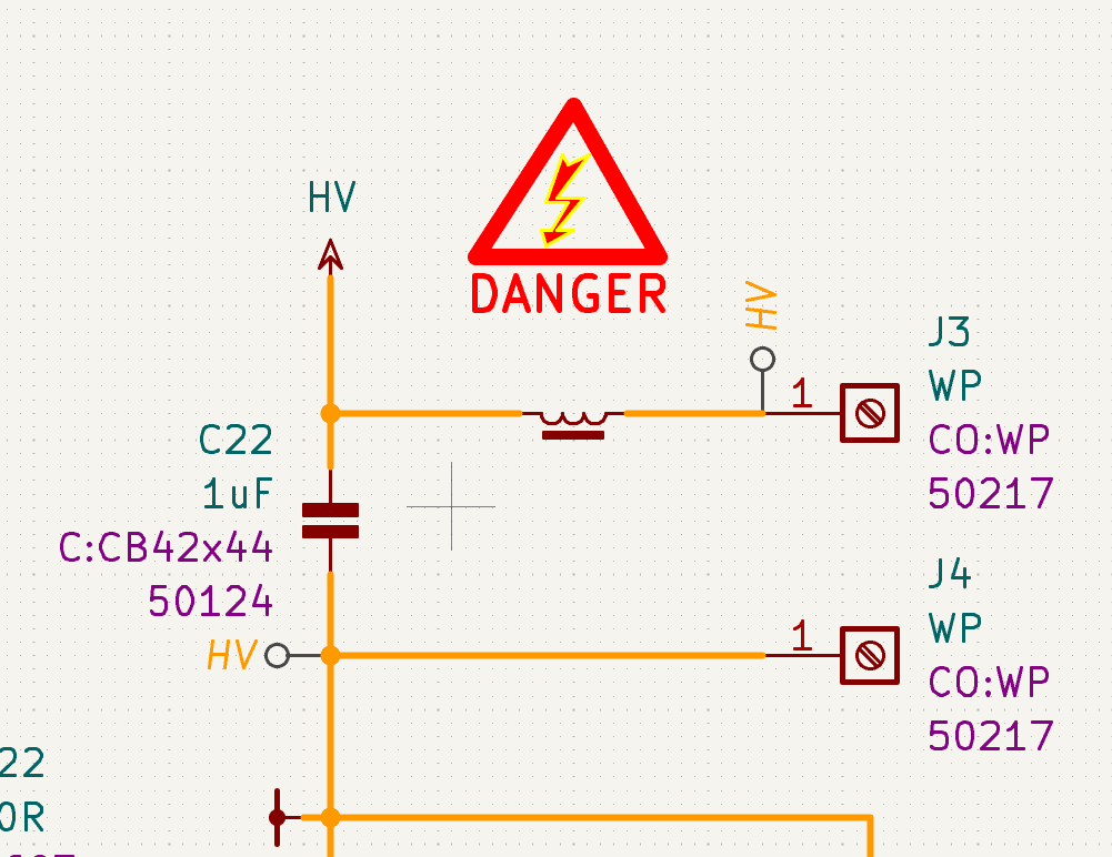

it is possible without a plugin, using netclasses (if you are on 9.0.x or above for sure, in prev. versions i don’t remember but i think not)

Net classes are not quite the same thing. Note the colored lines continuing through the inductors L505 & L506.
I think I prefer Net Classes though, as if printing in B & W, the schematic would not look good with the above example.
that’s right, even defining a color with NC, this behavior could not be achieved.
Pretty close but not exact.
Yes, netclasses work a bit different, but I feel it’s a much better method then just using colored lines. But if you wish, graphical lines can have any color, width or transparency (opacity) setting you like.
