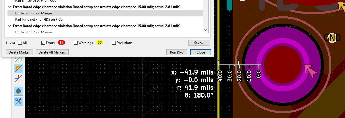

I’m receiving some solder mask aperture bridging DRC errors I don’t remember encountering before, and with the standard 1mm-2mm Fiducial footprint. Essentially the 2mm diameter mask is exposing the center (no net) fiducial copper dot, and my main zone pour around it is only 10mil away and so is also exposed.
I really don’t remember this happening before even though I use this footprint frequently. No matter, I copy and duplicate the fiducial footprint and add a circle on the margin layer to create a copper keepout. Re-link footprints to the new fiducial design, update layout, and now I receive a new error that the feature on margin is violating the board edge clearance of 15mil by being 2.81mil away:
Even though I’m measuring from the center of the 5mil wide margin circle here, I’m clearly >15mil away from edge cuts. Furthermore, that design rule setting the 15mil clearance is specifically “Copper to edge clearance”. Why is a feature on margin considered copper?
It looks like it’s actually complaining about the clearance from the margin circle to the no net fiducial pad.
Fine, I go into the footprint settings in PCB Editor and change the value in “Clearance Override” to 0mil and hit enter. Re-run DRC, same error persists. I have tried for both the pad and the footprint itself.

UPDATE: I added a pad clearance override to the fiducial pad in the footprint and set it outside of the mask area, and this resolved the issue. I have never encountered these errors with this footprint before so something must have changed somewhere else. Either way, resolved.
