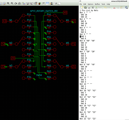

What baffles me about KiCAD is that the netlist is completely botched and does not remotely resemble the schematic.
I check with hold ing down G and moving placement parts and see that everything is connected. Unfortunately the netlist leaves out connections in nets and then brutally attach the net to something completely different not even connected in the schematic.

  1. The trouble I see here in the netlist is that Net 1 connects Sw5 Pins 14 & 18, which is correct but from the schematic it is obvious that Pin 22 is also connected. I did check that it is so by doing G => move
  2. Searching for Pin 22 in the netlist, there is only one entry and it seems to be horrendoulsy misplaced.
  3. If you look close to the end the Net 17 “X1 X1” connects this Pin 22 of switch 5A to completely absurd wrong pins namely Sw4 Pin1 and Sw1 Pin 8 !!! ???
    This is clearly incorrect from the schematic.

As far as I checked grid was 50mil.Thanks. That is a bit silly to connect to the grid. It means you shouldnt even have a variable grid. You are probably right. but that kills Kicad for me. I think that is a serious conceptual flaw to do things like that. Pretty bad to have connections take place that is not indicated by the schematic. Probably started as a good idea and then it started to bite later, but could not be removed as it is the basic glue that keeps the concept together. Thanks, I think that points out the conceptual flaw with this. I will have to look for something else. It is nice software otherwise, but with this kind of conceptual problems I dont want to venture into the Router and PCB placement sections. It can only be trouble having a variable grid but required connections on the grid and not the schematic.I just checked and the libraries has the same grid resolution than the schematic canvas at 50mil. Given that they are the same, that imho flawed concept will bite. Absolutes always create problems.
A 50mil grid is advisable but not mandatory. The standard library symbols have their pins on the 50mil grid.

The bug icon in the symbol editor will check if pins are off grid. So if you set the grid to 50mil in both the symbol editor and eeschema and use the bug tool to check that all pins are on the grid, you should be OK. [I am running the Windows nightly, but I believe the bug tool was already there in 4.07].

If it would really do that, all of our pcbs would be defect. I don’t even think there is such a bug in any kicad version. (Such terrible bugs are found during the development cycle. Very early on)
So my guess is there might be a missunderstaning regarding the workflow. (or regarding the interpretation of the netlist.)
I read further up that you talk about passive labels. Kicad does not have something like a passive label. A label connects stuff. Always!
regarding your installation problem: What is your operating system? The exact name of it and it’s version.
The symbol “6P4T_ROTARY_SWITCH_INV” appears to be badly wrong, it has duplicate pins. There is one other thing I noticed, one of the connections needs a junction symbol.
I think GIGO applies here. KiCad is working correctly but if you supply bad data it produces unexpected results, same as any other program.
