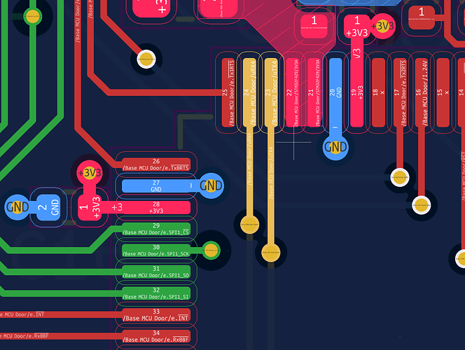

I have defined a few netclasses in a pcb project. The clearance of some of them is 0.5mm. This values make it impossible for tracks that belong to those classes to connect to pins of a fine pitch footprint.
I added this custom rule:
(rule "Reduced clearance for fine-pitch escape"
    (condition "((A.Width <= 0.3 mm && B.Type == 'Pad') || (B.Width <= 0.3 mm && A.Type == 'Pad'))")
    (constraint clearance (min 0.2mm))
but it didnt work.
Then this custon rule:
(rule "Pad clearance in U2"
    (constraint clearance (min 0.1mm))
    (condition "A.memberOfFootprint('U2')"))
again no good.
It seems that the violation is between tracks starting from two adjacent pads and not the pads themselves as I have suspected at first.
Is there any legit way to do this?

You can use the function intersectsCourtyard('x') for this.
This problem is recurrent, and grow every day since the chips are smaller and the impedance controlled tracks grow.
Sadly, the couryard exclusion is not a solution, because the tracks leave the courtyard before that the track can complaint the requisites.
On the leak of this function on kicad i I found a partial turnaround (not good solution) Is exclude the cleareance when the another part is a pad, and when another part is a track. On this mode you can ensure the distance to the ground plane but need take carefull at hand to another tracks.

(rule "BGA neckdown"
   (constraint track_width (min 0.2mm) (opt 0.25mm))
   (constraint clearance (min 0.05mm) (opt 0.08mm))
   (condition "A.intersectsCourtyard('U3')"))
I don’t have much experience with these custom rules so I’m at the limit of what I can advise here.
Yes, but BGA has a more large distance from the ball to the couryard border.
Another thing is make a own footprint with a large courtyard. This is not a solution, but maybe help
(Ab) Using the courtyard is a convenience because it’s already present in most cases, and reasonably sized. If you need more room for the fanout, then adding a (named) rule area is probably a better solution.

It seems that the clearance violation is not between pads and tracks but tracks conencted to adjacent pads.

The problem seems to be copper to copper clearance in your Board Setup > Design Rules > Constraints causing the track problem in your image. You need to halve the clearance.
Highest priority for DRC is the Copper Clearance defined in Board Setup.
Then the DRC rules, with the last one having the highest priority.
Then netclasses and other Board Setup values. (They are actually turned into rules under the hood; your custom rules are appended after them so have higher priority.)
