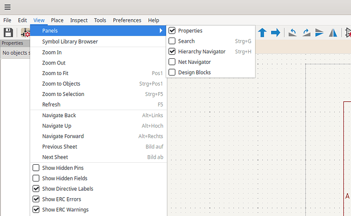

I have a question regarding the Net Navigator panel in the Schematic Editor.
If I open the schematic editor when the net navigator panel is disabled and then enable it it’s empty. It will be filled if you either
  • close the net navigator panel and enable it again
  • close schematic editor and open it again
  • run ERC
Is this a bug and should I open an issue in gitlab?
Steps to reproduce:
  1. Open Schematic Editor
  2. Make sure Net Navigator is disabled. If it is enabled disable it, close Schematic Editor and open it again
  3. Enable Net Navigator (it’s empty)
This happens in kicad nightly and 9.0.1.
