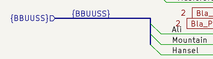

Again, have a look at my example. It has got a lot of weird details in it.
Take for example this part of the BBUUSS bus (I also have a normal bus and a Truck_ bus :slight_smile: )
The bus members of that bus are defined in the aliases in: Schematic Editor / File / Schematic Setup / Project / Bus Alias Definitions
Another thing that may make my example worth studying is that it uses nested buses {BBUUSS} is also a member of the Music bus, and it uses two identical hierarchical sheets (each with a connector) but on the PCB there are cross links with different bus names.

The use of aliases is (from what I understand) just to clean up the schematic. You don’t have to put all the member names on the bus itself, and if you add names to the alias list, they are available anywhere the bus is used.
I see. Makes sense when thinking about it. So instead of having {SDA SCL} everywhere I can make an alias named I2C… gonna try that out now!
That works too. I had to go to schematic setup in which I could creates aliases. Than I had to replace {SDA SCL} by {I2C} at all places.
