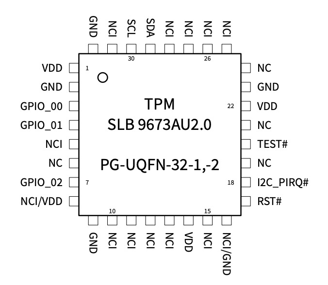

I’ve been dealing with a 32 pin part that has 4 NC pins and 13 NCI (not connected internally) pins, which is proving a tricky case study for my NC pin handling strategy.
Fundamentally I’m of the opinion that leaving out pins in a symbol introduces unacceptable doubt, though there are practical limits (eg. DDR BGAs with hundreds of NC balls!). This one is on the cusp.

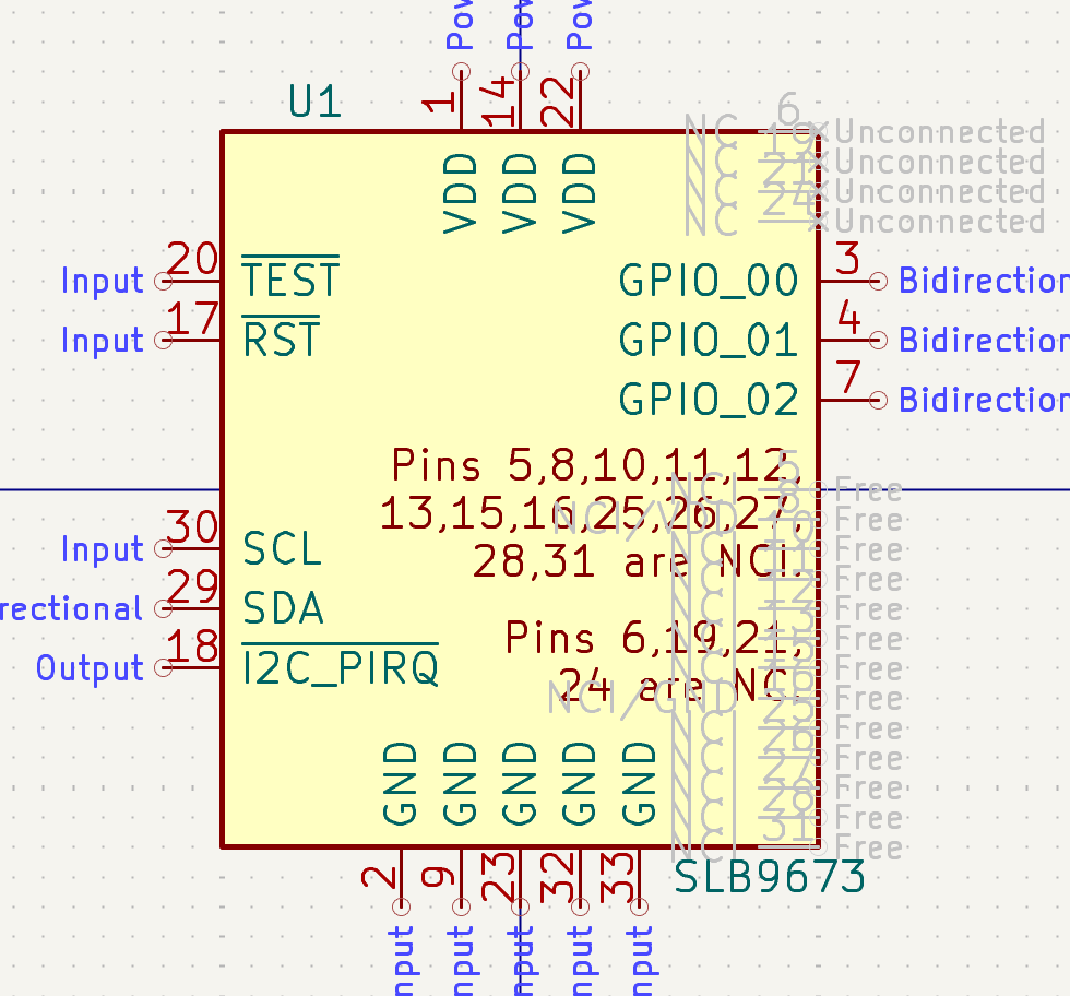

Originally I employed my strategy of stacking pins, but making the stack explicit. This didn’t work well because: (a) flipping the symbol doesn’t flip the annotation, and (b) stacking do-not-connect pins connects them (to each other)!

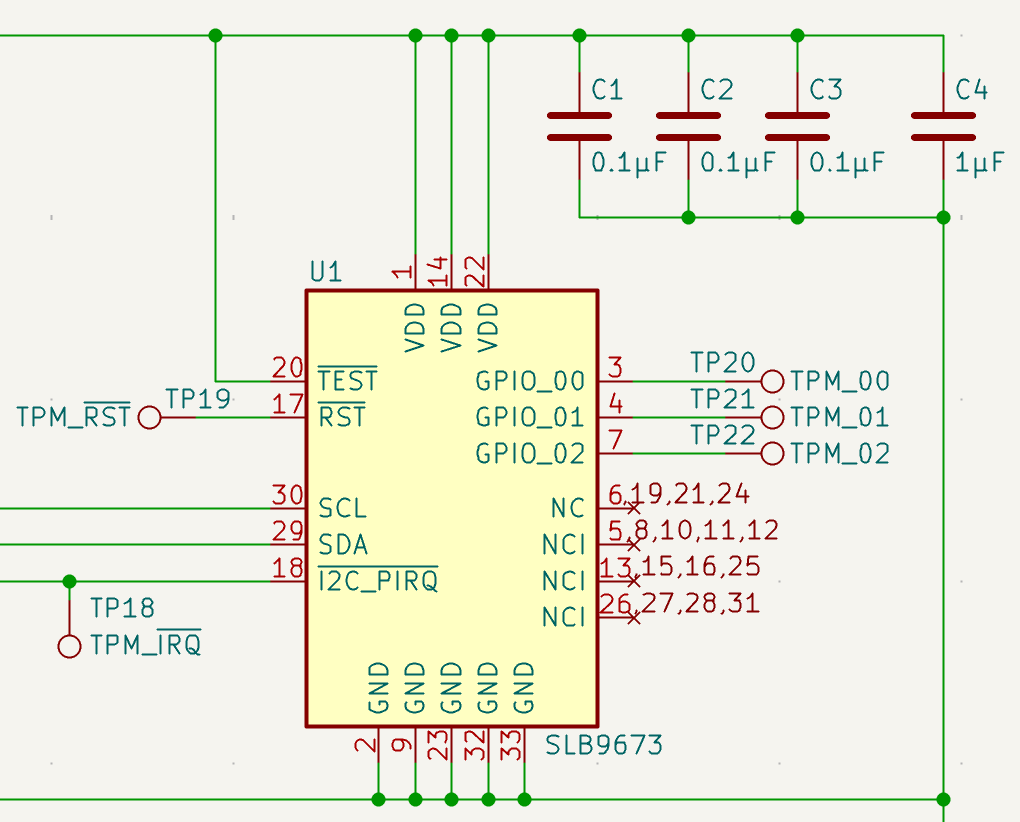

Here’s one: just use text! Good because the designer doesn’t have to bother dealing with pins they don’t have a choice about. Good because it’s not hard to edit the symbol and make a NCI pin visible if you want an explicit connection. Good because the “free” type means you don’t have to. Bad because even invisible pins can be accidentally connected to (nasty!), and it takes a lot of room to write it out.

You are lucky to have the manufacturer explicitly show NC means do not connect and NCI, which you might want to connect to ground for heat transfer.
Why is 16 NCI/GND?
Indeed. I’d hate to undermine that generosity in the symbol.
It’s because there’s a standard pin assignment for this family of parts, set by the Trusted Computing Group (TCG). To comply, pin 8 has to be VDD and pin 16 has to be GND. So the way they do that is make them NCI which means you’re free to connect them to VDD/GND, even though it wont do anything.

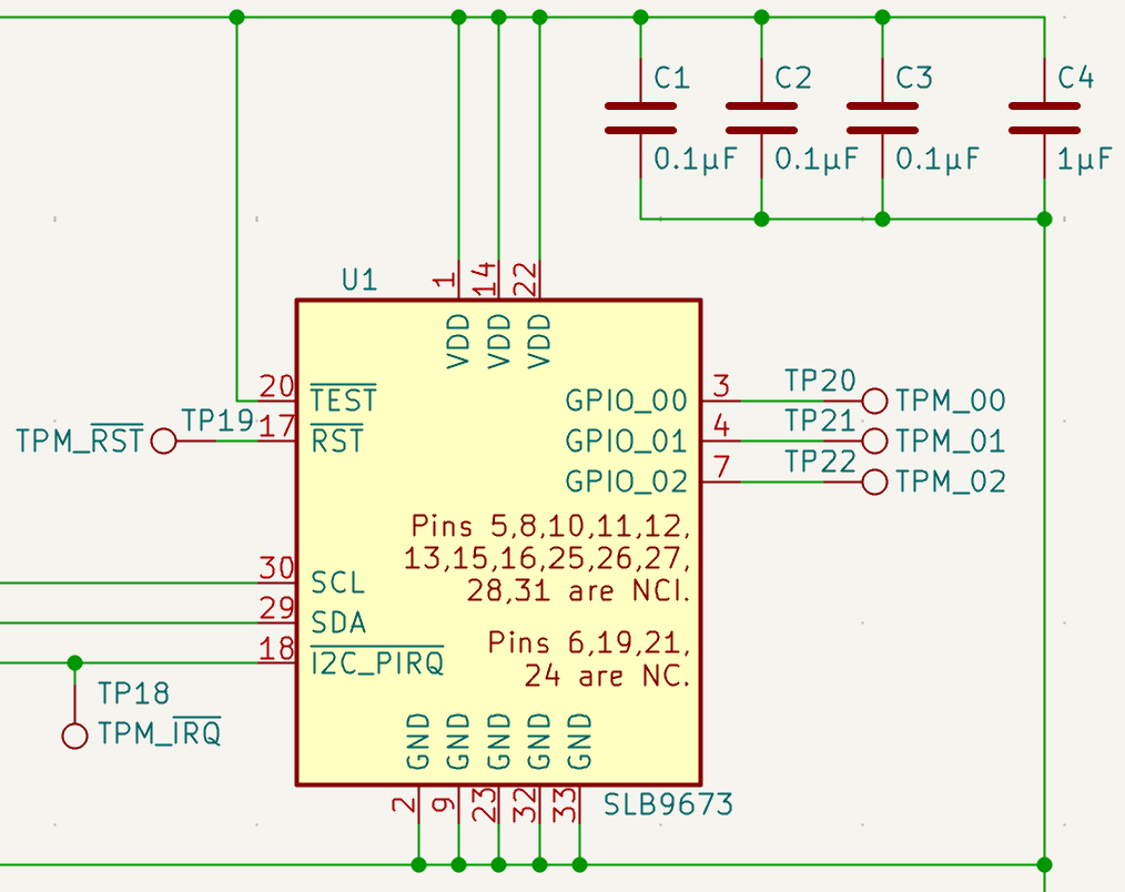

In the meantime, here’s what I’ve come up with:

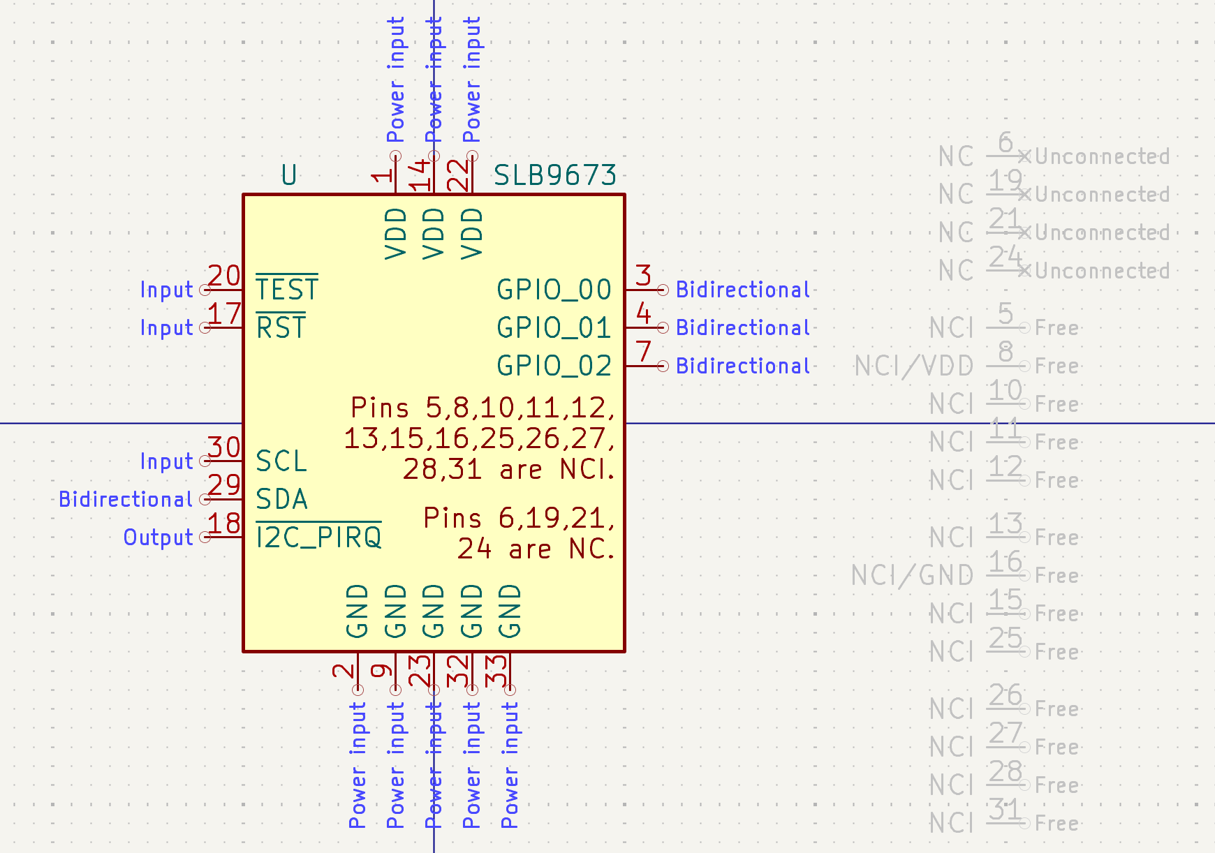

  • Invisible, unstacked NC and NCI pins
    • placed at the symbol boundary where they’re unlikely to be inadvertently connected to.
  • NC pins are “Unconnected” type. NCI are “Free” type.
  • Text within the symbol listing the NC and NCI pin numbers.
This strategy has the following characteristics:
  • Pro: a reviewer can see the purpose of every pin.
  • Pro: the pin count is correct, and the pin list can be reviewed.
  • Con: pin characteristics are partly visualised using plain text, which is unusual and duplicates the pin information in a way that can’t easily be automatically checked.
  • Pro: unlike a text annotation on a pin, the text within the symbol tolerates flipping in the x-direction well.
  • Con: the symbol has to be a bit bigger to accommodate all the text. Although not as big as would be required to fit all the pins.
  • Pro: no need to place a separate unit, or look for it when reviewing.
  • Pro: designer doesn’t have to do anything with NC and NCI pins. NC pins are automatically marked No Connect (by the “Unconnected” type). And NCI pins are “Free” to be routed to in the PCB or not.
I’m quite comfortable with those tradeoffs at the moment.
