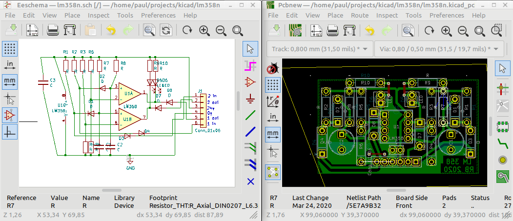

I am still trying to find a reason why my pcb page won’t load.
Usually when I first start up the computer it loads fine and I can work on it. If I close the Kicad down or close the project down to look at some other project I can’t get the PCB page to load back up no matter which route I use.
If I have the schematic up and I try to update the pcb from the schematic it hangs.
If I find the kicad_pcb file on my computer and click it the page opens correctly.
This means that I can see the PCB page by loading it manually but I cant update it with any alterations I make to the schematic. This happens on both my desktop and my laptop. The only thing I can see they have in common is the project itself. I have tried making a new project from the start with a different circuit diagram but still get the same problem.
I have uploaded the project, would someone with more knowledge of the programming mind seeing if they can see a reason why the pcb page won’t load from within the project but will when I load it manually please?

I did a bit of editing, and your project seems to work normally on my Linux Box.
I made some minimal changes.
  • Added GND symbol to schematic. (This gives GND net a name.)
  • Dragged schematic bits a bit around.
  • Updated PCB.
  • Added board outline on Edge.Cuts layer. (Always do this).
During updating with [F8] 2 warnings:
Then:
  • Assigned GND net to one of the Zones.
  • Hmm, now where is that other zone?
  • Ah, right on top of each other. Deleted it.
Note: I normally define a rectangular board outline and slanted edges for the zone outlines, and put them outside the board. The board outline cuts the zone outline rectangular, with a clearance depending on the lines on the Edge.Cuts layer.
Proof I opened your project:

Hi Paul,
Firstly thank you for all the time you are taking.
I unzipped the file you sent.
Opened Kicad, did file/open project and opened the files you sent me.
Clicked on the sch in the project panel and then on tools/open PCB editor. Everything opened as it should. I closed the PCB editor and tried tools/ open PCB editor, I did this a few times and it worked every time. I closed and opened the sch and did tools/open PCB editor a few times and it worked fine.
I closed Kicad and reopened it, opened the sch and did tools/open PCB editor, it hung.
Now it doesn’t matter which way I try to open or update the PCB editor it hangs.
I suspect when I come to it tomorrow it will work the first time and then not work again?
It is as if the programme is setting a flag that stops it from loading the PCB editor after closing down the programme but the flag clears at some later action, I assume when I shut the computer down. That sounds daft but it is the only reason I can come up with?
The PCB editor still loads if I find it in the directory and click on it.
Even if I click on the PCB editor from the control panel with the sch closed it still hangs?
I moved the file to another directory. This meant when I opened Kicad it opened with nothing down the left side of the panel. I then loaded the project and it worked fine.
If I close Kicad and reopen it I get the project down the left side and the PCB file hangs if I try to open it.
At least it looks as if I have found a way round it. Change the location of the project so Kicad doesn’t know where it is and loads it new when I ask it to?
