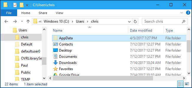

There are some rare reports of corruption of files in \users\yourname\appdata\roaming\kicad
do you know which files and what I can do about them?
If I go to local Disk\Program Files\Kicad\bin and double click on pcbnew.exe
The pcb editor opens. If I then pull down load and load my file it works perfectly so it is not the pcbnew.exe file that is corrupt.
A simple experiment with possible positive results is to rename the whole “roaming” directory to some weird name and then start KiCad and start a new project. This will probably restore those files to some default.
If this goes wrong then simply rename the directory back to it’s original name.
Try changing …\roaming\kicad to something else, not …\roaming

That “roaming” folder is what MicroSoft baked into Windows for a location for application settings. I don’t know why they called it “roaming”, but they did so that is what us Windows users have to use.
EDIT: I found this website explaining the windows settings folder hieararchy, and it actually does explain a little why it is called roaming:
