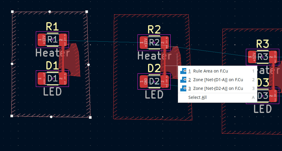

Uh-oh… this may be a different issue but it seems there - are- some gremlins after all.
Each target area contains two replicas of the sheet’s internal node - one for the original sheet, one for the target sheet.
Should probably make this a separate topic but anyway, attached my observation:
That’s exactly the problem and explains why I am sometimes seeing the copper pour merging and sometimes not; it is because you have U2-pin1 and U5-pin1 filled zones with equal priority fighting one another.

Please see attached for an example of the problem. All you need to do is “Repeat layout” and select the leftmost rule area.
multichannel_bad.zip (18.2 KB)
Now click on the generated copper pour and you see this:

Description:
In multichannel design, target areas receive identical copies of rule zones from the reference area in addition to correct rule zones derived (not identical) from the reference ones
Steps to reproduce:
  1. Place a component in a hierarchical sheet.
  2. Go to layout and layout the single component of the first hierarchical sheet with an additional hand-drawn polygon rule zone named after a net of one of the component pins (you will need to untick “hide automatically generated net names” for this).
  3. Create a rule area around the rule zone and set the placement to the first hierarchical sheet.
  4. Copy just the rule area 4 more times nearby, non-overlapping.
  5. Draw an edge cuts rectangle around all the rule areas.
  6. Do Multichannel → repeat layout.
  7. Check the rule zones in the target areas. See that there are unwanted duplicate rule zones of the reference area, as well as desired renamed rule zones.
