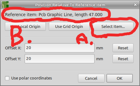

Also note that the Position Relative To Reverence Item window has a few more buttons. With the Select Item you can point at any location to use as an origin (and it remembers that “origin” for the next mounting hole you want to place). In the screenshot below I did:
A. Click on the Select Item and then click on a line on Edge.Cuts to use it as a reference:
B. The dialog shows that the line is used as a reference during placement.
C. Enter offsets for X and Y.
D. Press [OK]
There is also an Use Local Origin button and thanks to eelik’s post below I now know that positions stuff relative to the last location where you pressed the [SpaceBar].
