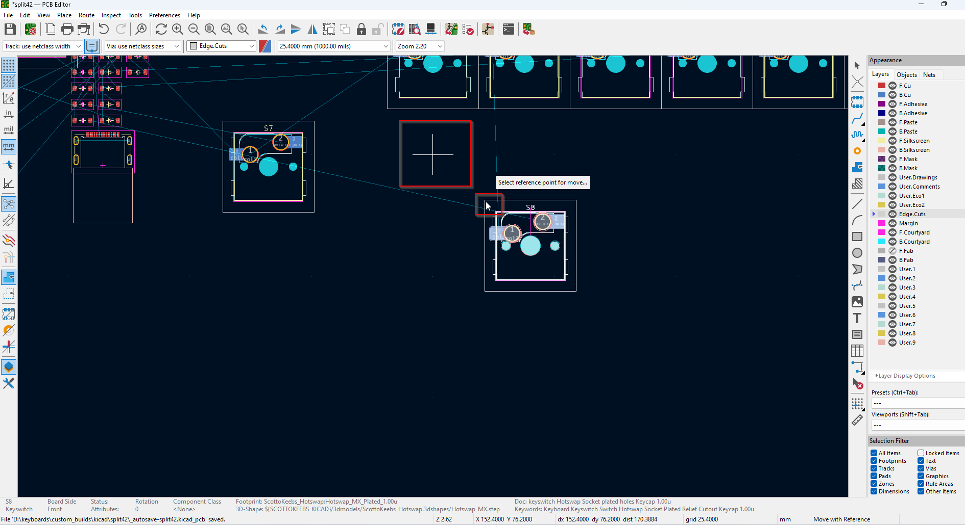

I want to make a PCB for a keyboard. I made the schematic and after I imported the component in the PCB editor I want to arrange them. I watched a tutorial and the guy have a pretty big grid and when he selects “Move with reference” the software allows hims to select the corner of the component. This is not possible for me, when i try to do it, the software allows me to only select the point on the grid, but the components are not correctly positioned on the grid. You can see in the screen shot.
I am using KiCad 9, I am not sure if any other information is needed. Thanks in advance.

My example shows that I have accurately placed the cursor on the corner, but it does not show that to do this I am using a 1 mil. (0.0254mm) grid.

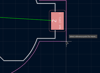

The Move tools are definitely borked in 9.02 and 9.03. None of the snaps get highlighted, although the ruler tools work correctly.
OK, so the problem is: The default snaps are “wrong” in 9.0x.

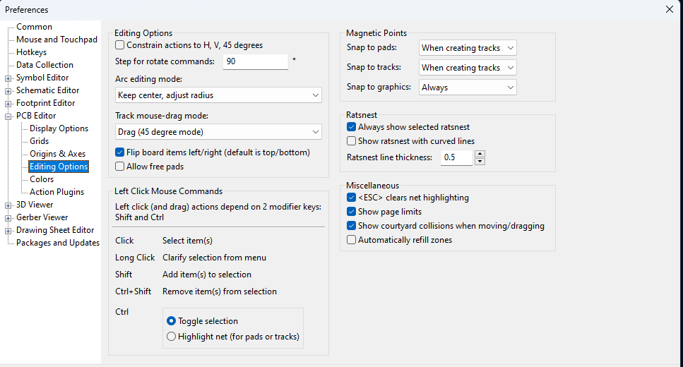

Change them here, and the problem goes away:
Snapping to different types of objects (pads, tracks, and graphics) can be configured in the Editing Options section of the PCB Editor preferences.
Hi, thanks for being involved in this topic. For me anything that I changed in Kicad v9.x settings, did not worked. I also tried the 9.0.4 version (the latest) and the behaviors is still the same. For me, the version 8 of Kicad is working good and is also good enough, so I will keep it for the moment.
These are the setting I have in both v8 and v9, I don’t know why it behaves different.
There are several settings that influence snapping behavior. I see you have Snap to graphics set to Always. That’s one setting, and that is good in this case, but there are more. One part of it is that sometimes snapping behavior for graphics is only for the currently active layer. Although a test in V8 I just did the Move with Reference also snaps to graphics on different layers. I’m not sure of further details about this.

Change the “Magnetic Points” to always.

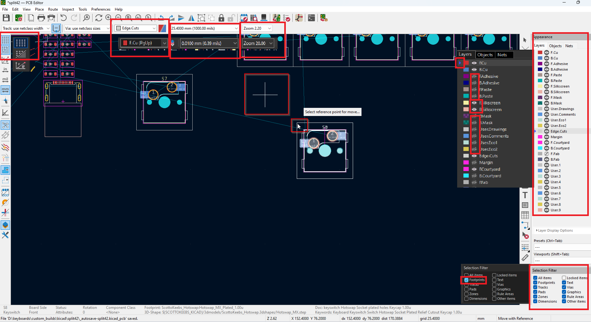

Regarding the points that no one else has commented on,
if I were to look at the first screenshot, I would start by changing the settings in the red box.
This isn’t directly related to your question, but it’s an example of a setting that will make things easier before you move.

It’s the “Magnetic Points” setting.
I changed everything you suggested, and nothing helped. Changing Magnetic Points to “always” fixed the issue.
