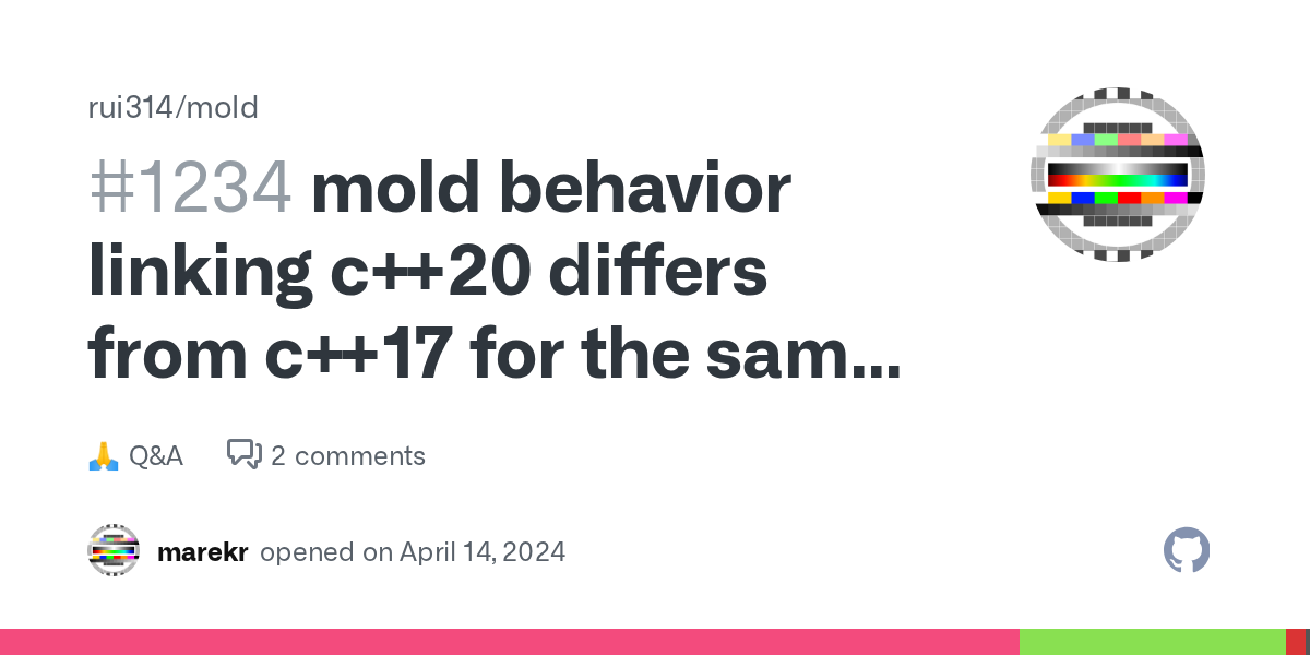

Mold unfortunately while a faster linker also has issues the maintainer denies exist (or rather probably too hard for a one man project to cover all the test cases). In particular when kicad simply switched c++17 to c++20 by simply changing the standard flag, mold suddenly produced linker errors that did not exist previously. That can’t even be explained because the gcc object dumps linked similar for the complained about symbols.
The errors you are getting are amusing because they are different then the previous issues that occurred.
Literally every other linker on all platforms works fine. Mold is just special and cutting too many corners.

Also these experimental linkers (mold bolt) mess with the link order to speed up but they are experimental for a reason so it’s clearly loosing symbols
Just stick with regular GCC or clang… Maybe use gold-ldd but not mold…

There are ways to workaround the issue in kicad, but we won’t, because it’s not our job to workaround bad linkers that aren’t mainstream.
