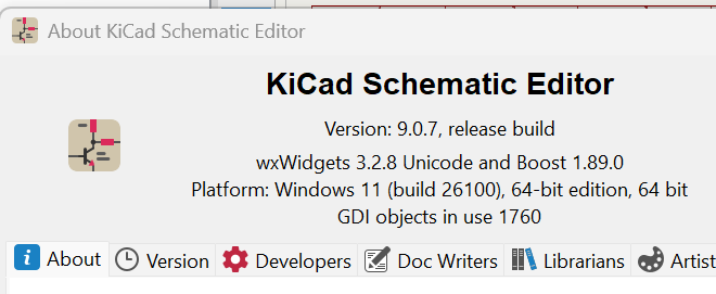

Originally used version 9.0.2? (not really sure about actual version number). Downloaded version 9.0.6. The line and text tools in the right hand tool bar are missing. I see version 9.0.7 has been published so I downloaded it. Same problem. Screen shot is below.
Running Windows 11.
Whilst running the install program I read a note saying I should uninstall the previous version of the program but when I ran the windows uninstall program it said it was already running. Found that a little confusing and may or may not be part of the problem. Any help is most appreciated.

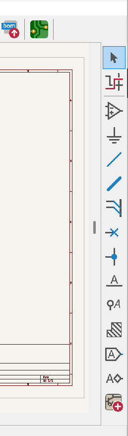

Most likely your screen doesn’t have enough vertical pixels to show the icons for those tools. But you can still access them from the Place dropdown menu.

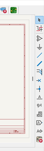

You must be running on a very small screen. I see this
Or somehow these icons have been made very large, so they don’t fit
Yes. Perhaps HiDPI mode on a non-HiDPI screen.
That being said, wxwidgets should do a better job of handling cases like this. Either displaying a second run of icons next to the first in a palette style or enabling some sort of scrolling.
The first screenshot is 878 pixels high, and that’s quite low. (Assuming the screenshot itself is not scaled.)
The icons in the screenshot are also quite big. By reducing icon size, you can fit more icons in the toolbar. Icon scaling is in: Schematic Editor / Preferences / Preferences / Common / User Interface / Toolbar icon size. In KiCad V8.0.9 this has the settings “Small”, “Normal” and “Large”. I think that most OS’es also have built in functions for icon scaling. That became a thing when monitors started to appear absurdly small pixels. I never bought such a monitor, so never had to fiddle with that. (My 4k monitor has 107cm diagonal, so still a normal pitch (945/3840 = 0.246mm))

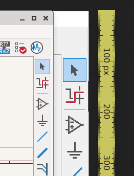

Another complicating factor is picture scaling by both this forum software, and by web browsers. On my pc, the original screenpost is nearly identical in size as my real schematic editor, but it’s scale by the discourse forum software. when viewed in “original size” there is a significant difference.
Below a comparison.
  • Left: My KiCad V8.0.9
  • Center: Screenshot from OP.
  • Right: A screen ruler that counts pixels.
Exactly. My icons were set to normal. Selected small and they all showed up. Using a laptop with a rather small display. Thank you to everyone for your sage advice. The help is truly appreciated.
Dan
In the comparison screenshot I made, my icon size was also set to normal in KiCad, and they are 32 by 32 pixels, while yours seem to be 48 by 48 pixels in “normal” size, so apparently something else is also scaling pixels.
As I look through my display settings I see scale - change the size of text, apps and other items is set to 150%. 150% of 32 pixels = 48 pixels. This is the recommended setting. i must admit my laptop display has always been a little strange. Kicad tool bars appear to be working. I think I will leave well enough alone.
I’d find that a strange recommendation for such a low resolution display. These “display settings” probably influence all other programs too. Setting this general setting to 100% and leaving KiCad at “normal” makes more sense to me. But it’s your hardware and your mental state :winking_face_with_tongue:
Yes, sounds strange to me as well. Makes no sense. I have a five year old Dell Inspiron 13 7000 Laptop. 13.3” screen as measured diagonally set to the recommended 1920 x 1080 resolution. If I select 100% in the display settings the text shows up as circa 7 pica. Even with glasses it is essentially unreadable for this 76 year old man. So 100% is too small, 150% doesn’t show the bottom of the pcb editor tool bars. As far as I can tell 125% is readable with a little squinting and appears to show complete tool bars, so I will use 125%. Am not going to spend a lot of time on it as I’m overdue for a new computer. Just need to get the immediate task of making a pc board out of the way first.
