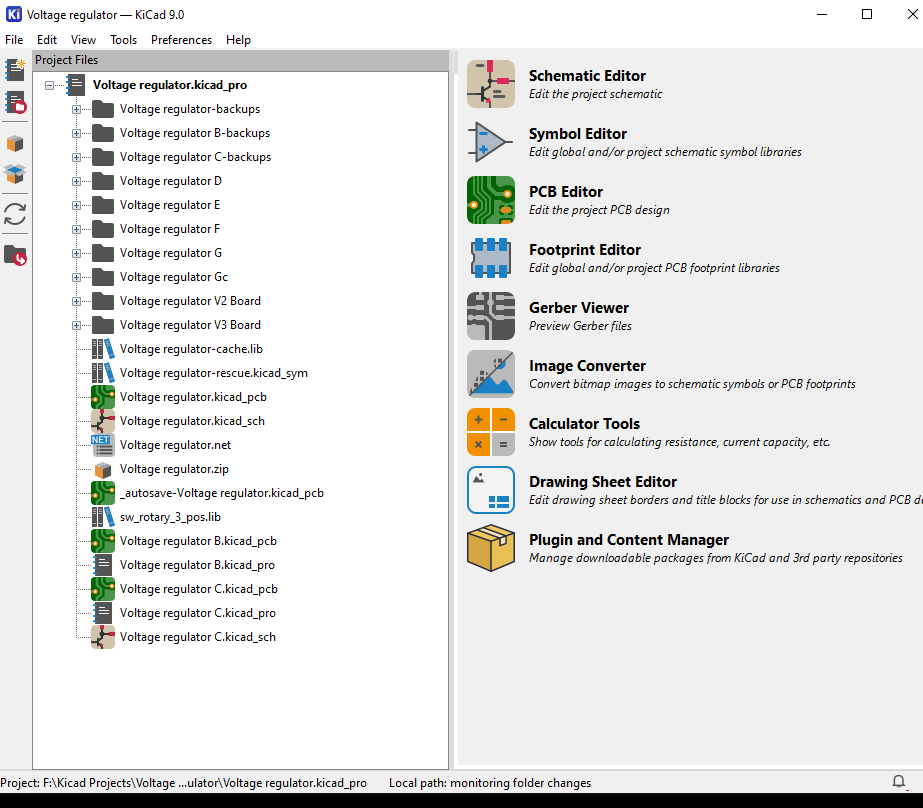

I was running Ver. 7 and couldn’t get the symbols to load but a few categories would. Today I saved my project, deleted Ver. 7 and installed 9 (Win 10). Everything went well. I ran a sample project and the libraries all loaded without a hitch. I then loaded my old problem child project and began working with it. When I went to add a component to the schematic the problem reared its ugly head, only a few component categories had anything in them. I looked in the folders and everything was there. I even edited the path just in case. When pulling up the main start screen I see no pertinent library files listed. If a picture is worth a thousand words so here are a few thousand.

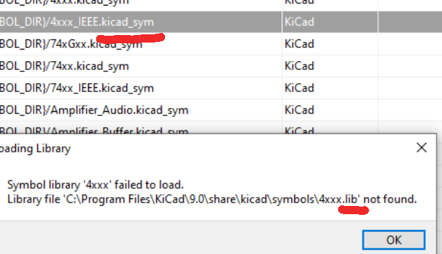

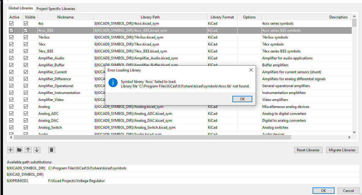

I wonder why at list you have .kicad_sym but Error says about .lib.
I am using only my own libraries so each new main number version I just say to use list from previous version and was not watching that list for years so I even don’t know which one file extension is correct.

Did you read Piotr’s remark:

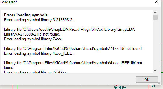

The *.lib files can exist in KiCad, but they are symbol library files in the old format. (I think older then V6). So the error message is not about the greyed / highlighted line (did you select that line yourself?) But it’s about some other file. Maybe it is in the Project Specific Libraries tab.

I have fixed the “read only” error but I am still getting the same error when I go to place a new component. Usually I can figure things out and have tried many suggestions that I have read online but this one has me stumped. it appears that there is something that is still lingering after a de-install that the installer is picking up on. This is actually a very long list….

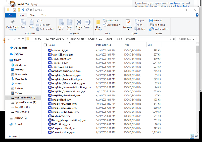

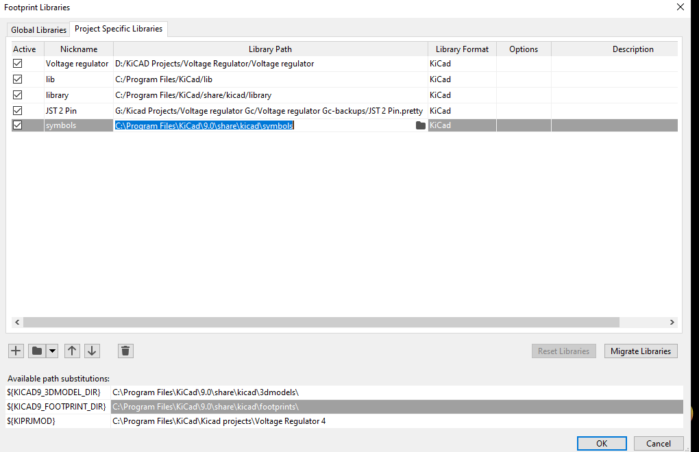

Ah, I just saw your post. I understand. It is what I was thinking in the back of my mind. However, I haven’t been able to figure out how to add the library to the project. From what I have read, I need to go to preferences - Manage footprint libraries - Project specific libraries and then add a path. However, I don’t see any symbol files in the correct path. C:\Program Files\KiCad\9.0\share\kicad\symbols. If I navigate to “footprints” there are many files there, just none in “Symbols”. I need to somehow find the symbol files before I can place them there. Where can I find them? I can’t seem to find them anywhere.
Your last screenshot is for the footprint libraries. There is a very similar window for the symbol libraries. There is also a chapter in the schematic editor manual / help file that explains how it all works.

I understand that the libraries work similarly but the symbol library is empty. The symbols that I do have are the ones that are in the project at hand. I am beginning to believe that I need to download the symbol library from an internet source. I have done a full search of my computer and the main library isn’t there. I thought I had deleted all related files when I reinstalled but the library didn’t install just the same. I tried to find the library but couldn’t. It is sounding like I need to install on a virgin PC and then copy the library. I will give it a try. I will report back after I find a solution. I appreciate your help.
