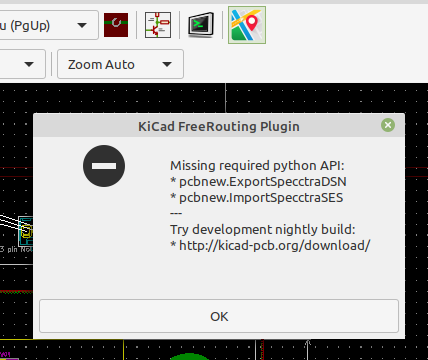

Tried that, it also seems to want the nightlies:
