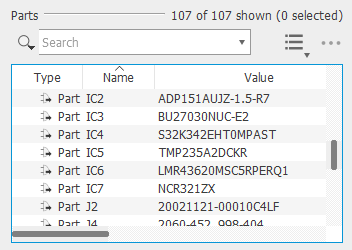

Migrating from eagle, selecting placed parts from list?
Is there any equivalent to the Parts/Devices view in Eagle which contains all the footprints or symbols to select and focus the window on?

I think you are looking for the “Symbol Fields Table”. This is available in the Schematic Editor, from the drop-down menu in “Tools”, and also has an icon in the row across the top of the workspace (third from right, next to BOM). A hotkey is also assignable to this function.
PCB Editor / View / Show Search Panel You can select footprints here, but KiCad does not pan to them. With the t hotkey in the PCB Editor you can also fetch a footprint and attach it to the cursor without knowing it’s previous location.

The search panel was what I was looking for, it does pan the view too.
