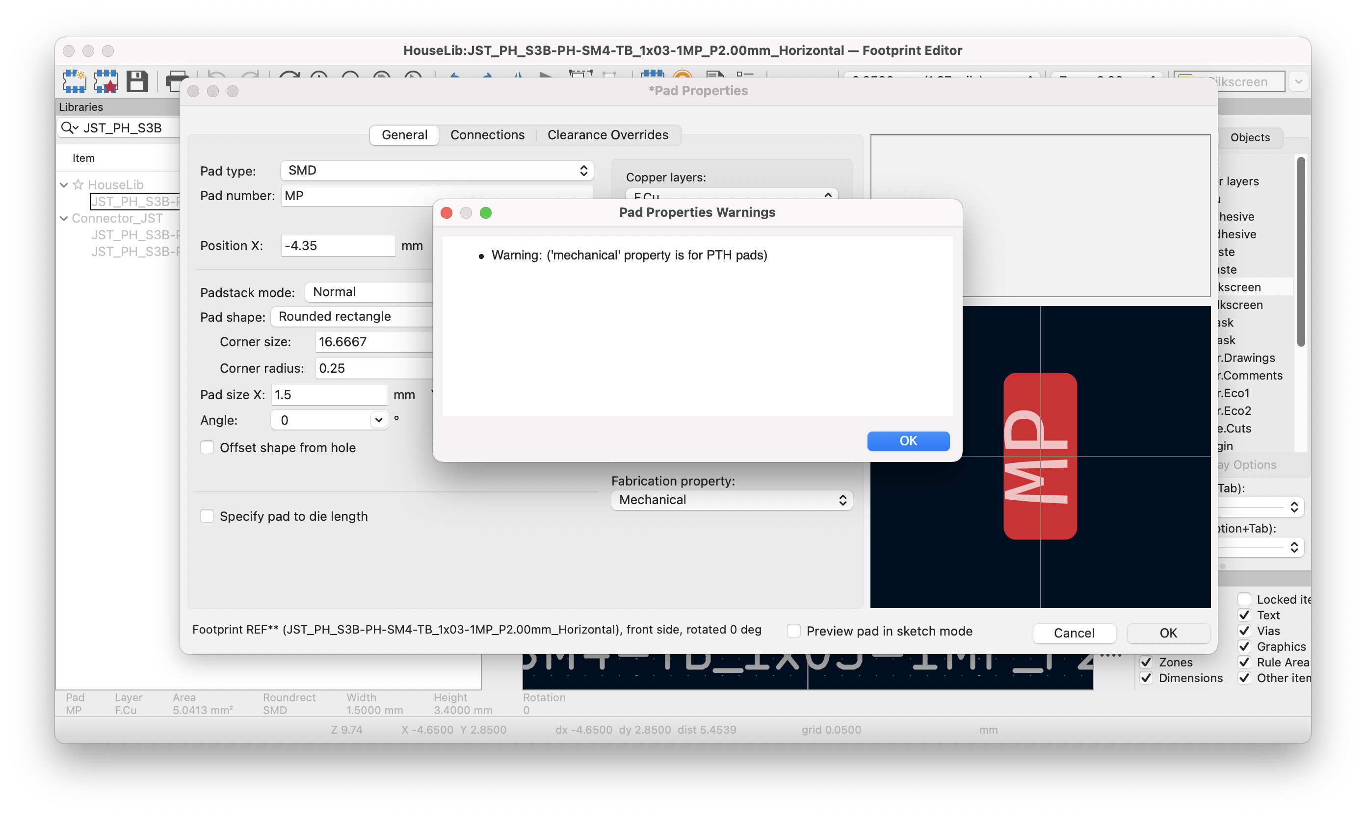

I’d like to keep the pads, but not have them appear in the schematic. It turns out the new(ish) “mechanical” fabrication property allows this… nearly.
The first issue is, this property is not designed for SMD pads, and you’ll be warned as such when applying the property:

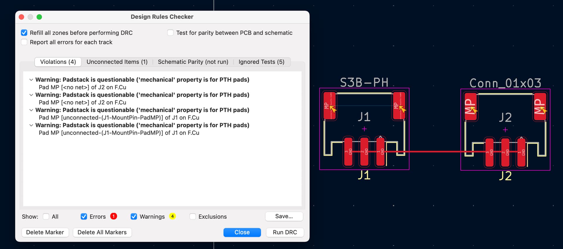

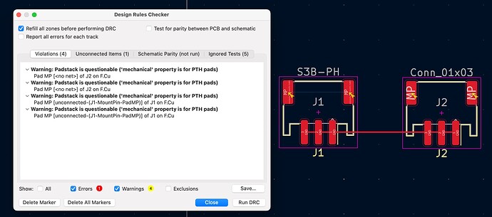

The next issue is that you’ll be further chastised for the questionable choice in the DRC:
J1 is associated with the MountingPin symbol. J2 is associated with the Generic symbol. Both have the “mechanical” property set on both MP pads.
Other than those issues, I think this does just what I want - there’s no MP pin in the schematic, I’m not required to connect them together in the PCB, and there’s no “unconnected net” error in the DRC.
