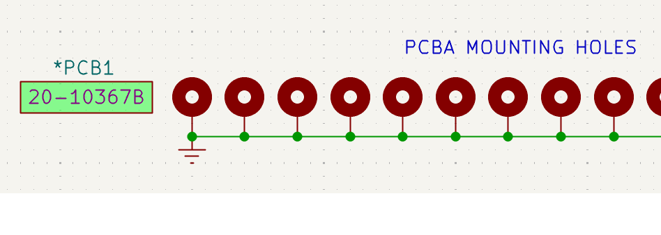

So, I have made a schematic symbol for the mounting holes that I can add to the schematic. I find this very handy, as I will not have to add manually the holes to my PCB.
I think others are using a similar approach, too.
I was now thinking about how far I could go with this. Would it make sense to add other things too, just to have them in the BOM?
For example, I am thinking now about preparing different footprints for board shapes that I often use, and also place them as “non electrical” symbols on the schematic, such that I can even select several different, predefined board outlines from the schematic. For instance, if I am using a funny shape for my PCB, like PCI cards and such. Does anybody use a similar approach?
I am also thinking about how far this could go and what would make sense. For instance, one could also add caps for switches, the case, or screws, but after a certain degree it gets silly, so I am wondering how others do it.
For instance, in the one company where I worked, we had the company logo, certain labels and stuff also as schematic symbols with a footprint attached, such that the components get imported to the PCB automatically.
I am using a database library, so I have linked everything already with manufacturer part numbers and such, so if I generate the BOM, all is included already which is very handy.

Same here. Attached is my simple PCB symbol. I give it a RefDes of *PCB so it sorts as the 1st line item on my BOM and I don’t mistakenly omit it. It’s arguably the most important component in a PCBAssembly
