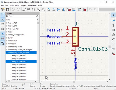

Another solution might be (I would probably do it this way for the implicit documentation) to use a different symbol on the schematic. I quickly found this one:
and this one:
Choose the “proper” one depending on if the extra pins are just mounting pins embedded in a plastic housing, or are actual metal connector shield pins.
And then on the downloaded footprint change both the S1 and S2 pins to MP or SH (depending on which symbol you chose). In KiCad a pin “number” doesn’t even need to have numbers in them.
This will allow you to either connect the shield/mounting pins to GND, AGND, DGND, ChassisGND, etc. or put a no-connect on it, and when troubleshooting this board a couple years in the future when looking at J16 on the board and seeing a 3-pin connector you can find it as a 3-pin connector on the schematic.
