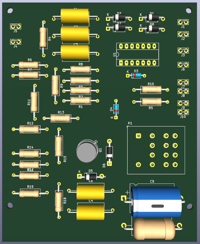

For sake of experimentation, on the advise of another user, I tried a footprint for a similar sized relay just to see how the footprint fits and allow me to rearrange the other parts and make ready for when I find the correct part.
The PCB layout is looking much better now.

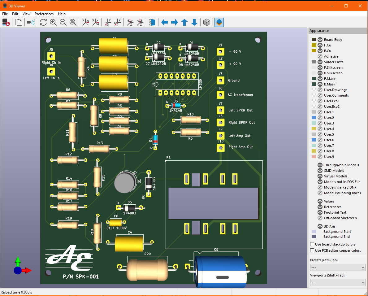

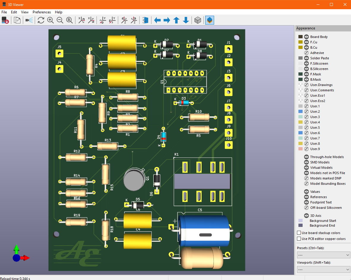

I got creative… and figured I’d try making a workaround so I could mount relay directly to the PCB. The rectangle cutout is to accommodate the plastic partitions between rows of pins on the bottom of the relay.
Some of the net names are confusingly inconsistent from pin to pin, but the rats nest all point to the right connecting points.
DRC only finds silk screen overlaps, but no electric errors now.

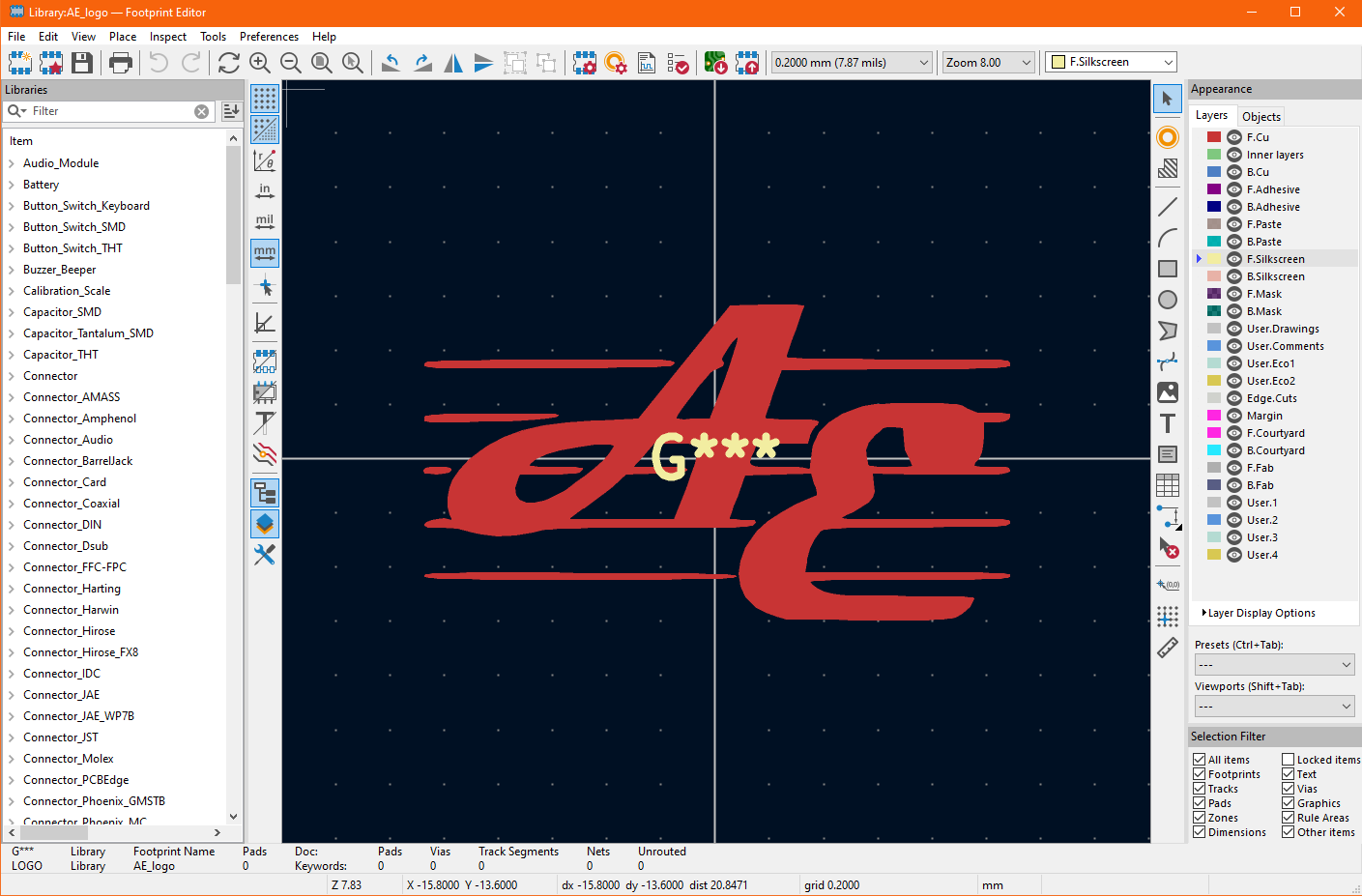

I even figured out how to get my company logo on to the PCB. Supposedly it’s on the silkscreen layer, though to me it looks like copper with conformal coating over it in this 3D preview.
It doesn’t look like it, it should look the same colour as the refdes and courtyard rectangles. Check your logo layer again.
According to the properties, it’s Silkscreen, but you’re right,. it doesn’t look like it.

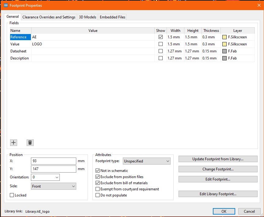

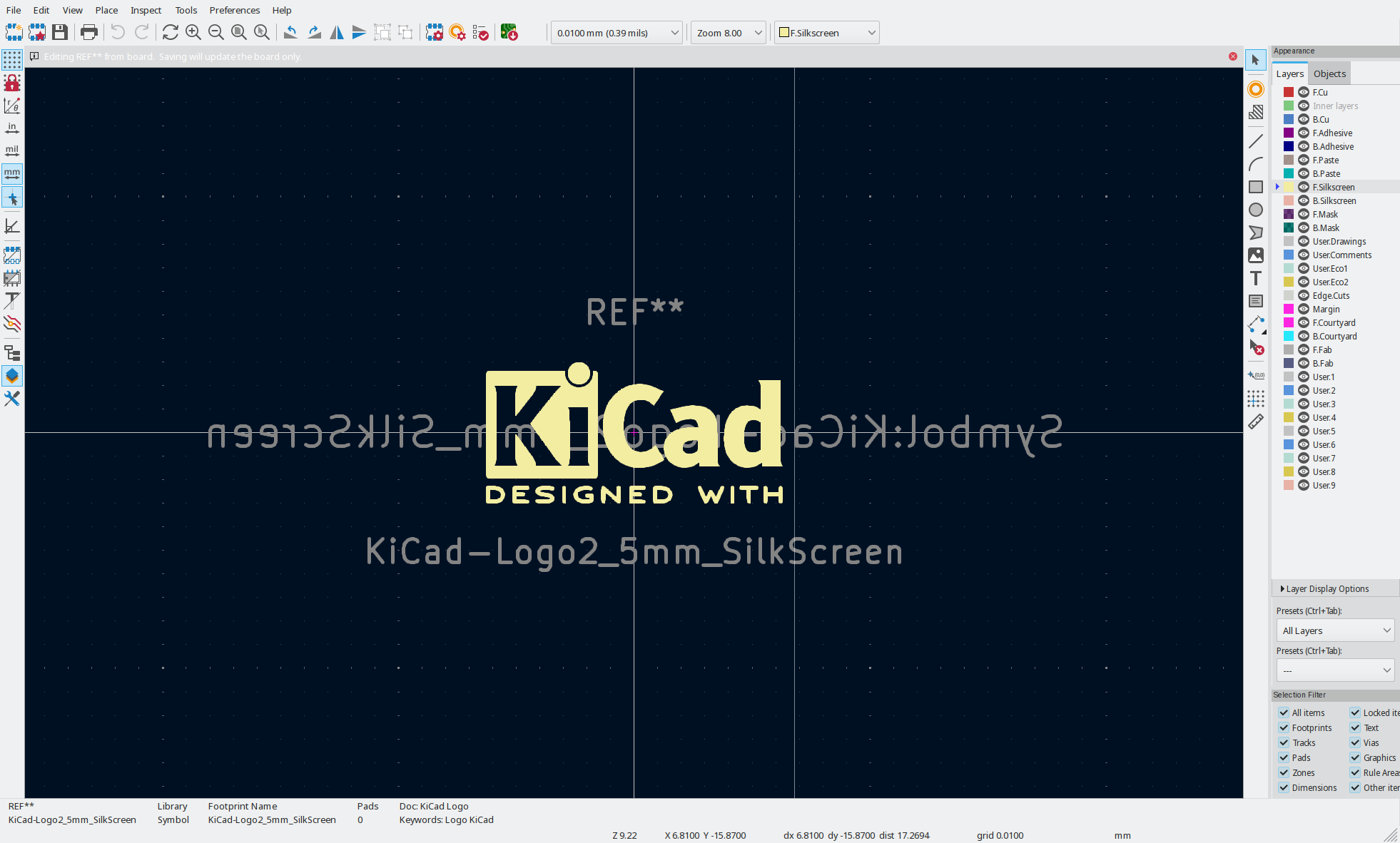

That however is saying that the refdes and value properties are on the F.Silkscreen. You have to look at the footprint. Here’s what the KiCad logo footprint on my board looks like when I edit it. Notice that the dropdown in the middle says that it’s on F.Silkscreen.
If you were looking at a footprint with pads then those would be on a Cu layer.
Edit: In fact if you had put your logo graphics on Cu in the footprint that would explain the appearance, a copper logo under soldermask. Also it’s easy to check. In a Gerber viewer turn off Silkscreen. If the logo remains visible it’s not on Silkscreen.
I thought I could simply cut it from the Cu layer and paste it into the silkscreen layer, but it’s still in the Cu Layer.
How does one move this to another layer? I’m sure there’s an easy way, but I haven’t found the menu or command yet.
Select the graphics then use Edit > Edit Text & Graphics Properties ticking Selected Items to change the layer.
It was on a ‘hidden’ menu… had to enable it under the View menu. Thanks!

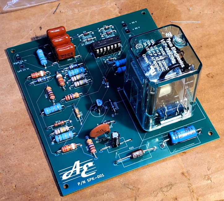

I thought I’d update this thread with the finished result…
Ain’t she purty? I started tested today. It works. I just may change to a relay with a higher coil resistance, as this one’s pretty low and makes the driver transistor run hot. Or I may try a MOSFET with a low RdsON value. Time to experiment!
It’s nice to see a finished project, thank you.
My only criticism is I’d have preferred to see bigger pads and wider tracks everywhere, especially as there is lots of spare real estate and the PCB is supporting a large, heavy, relay.
