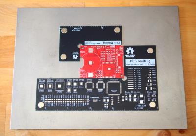

I’ve designed a simple magnetic (or taped) jig for holding PCBs while solder paste is applied:
https://climbers.net/sbc/pcb-multijig-stencil-holder-ruler/
IMG_8294_metric_sm
IMG_8299_steel_sm
while I was at it, I added metric + imperial ruler, common SMD/SMT footprints, Raspberry Pi+ESP pinouts, etc. Feedback very welcome!

Looks good. Where did you print it from?
What do you mean? I designed it myself.
everything is great, but the question is what to do with the installation on the second side of the board?
Hi it looks very nice. My problem has been easily getting the stencil alligned. Could you add some placement holes to hold the stencil, so when you cerate the stencil you make sure the holes you add are where your holes are then you could possibly pin the stencil down and it would be perfectly alligned to your board? It does look very good, but what do you mean “magnetic solder paste stencil holder” ?

Thanks :slight_smile: The 3 holes in the corners can take little magnets, so the jig is fixed in place onto a steel sheet. Or you can just tape it down with masking/painters tape. It is all in the article if you click the link.
Agreed. It would be nice to have a more automated alignment system. There are the 6 corner holes that the magnets go in. You could perhaps create stencils with the same holes, and use thicker magnets as ‘pegs’ that the stencil is hooked onto for alignment? I could see that working well with steel stencils.
There are also some through-holes on the jig, so those could potentially be used for stencil alignment with little pins?
Personally I’ve found manual alignment fairly straightforward with a bright work lamp (to reflect the pads) and a small magnifying ring. That is good enough for down to 0.5mm pitch ICs.

Ah, do you mean if you need to apply solder paste to both sides of the PCB? This jig wouldn’t be suitable for that.
I think he meant where did you get them built.
