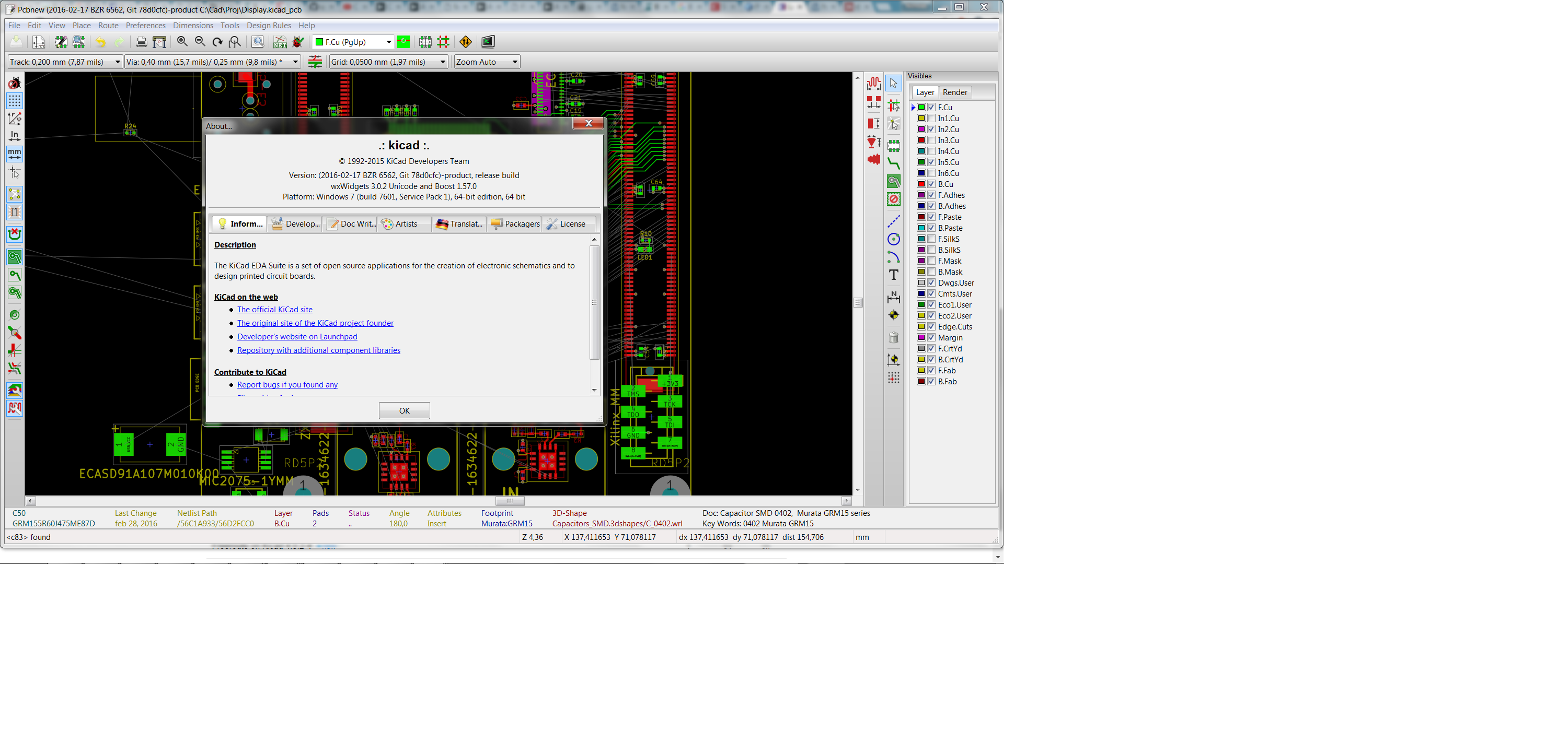

cant find a way to lock vias and tracks
is there a way ?
thanks

so, which version do you run and on what os?
Afaik @kammutierspule’s screenshot is the default canvas (‘regular’ for you).
Any chance you still got the footprint mode active (some button at the top row icons with an IC with arrows on it)?
In “Regular” canvas, you click on a track, right click, and there is that drop down menu.
Works in Legacy not in Cairo

Also open GL did not have the lock flags only Legacy
