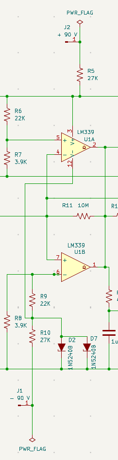

Or spawn off your own opamp symbol and add the power pins to one of the ‘Units’. I don’t really like the notion of (5) units for a ‘quad’ device:

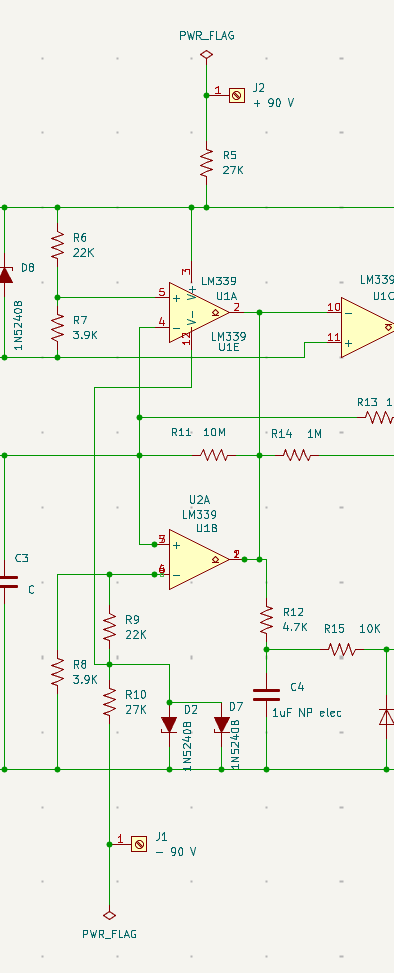

So something like this… I’ve added power flags for the 90V rails. Added part E over the top of one of the other parts:
Your method seems more elegant, and I agree about the number of devices. Is this a process for the symbol editor? I assume I can take a standard part, use as template and save as new library item?

I was able to place Part E right over the op amp, so the schematic looks traditional in the manner I have drawn them 50 years ago.

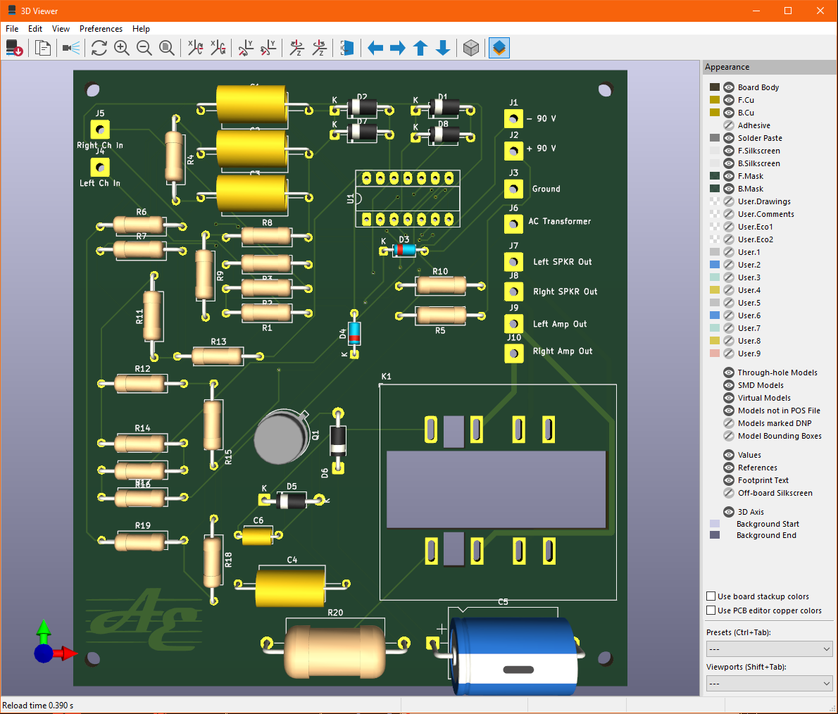

The whole PCB has come along nicely. I got creative, adapting the PCB to a plug in relay I have already bought.
Board checks look good, except for some overlapping silkscreens. No electrical problems flagged.
