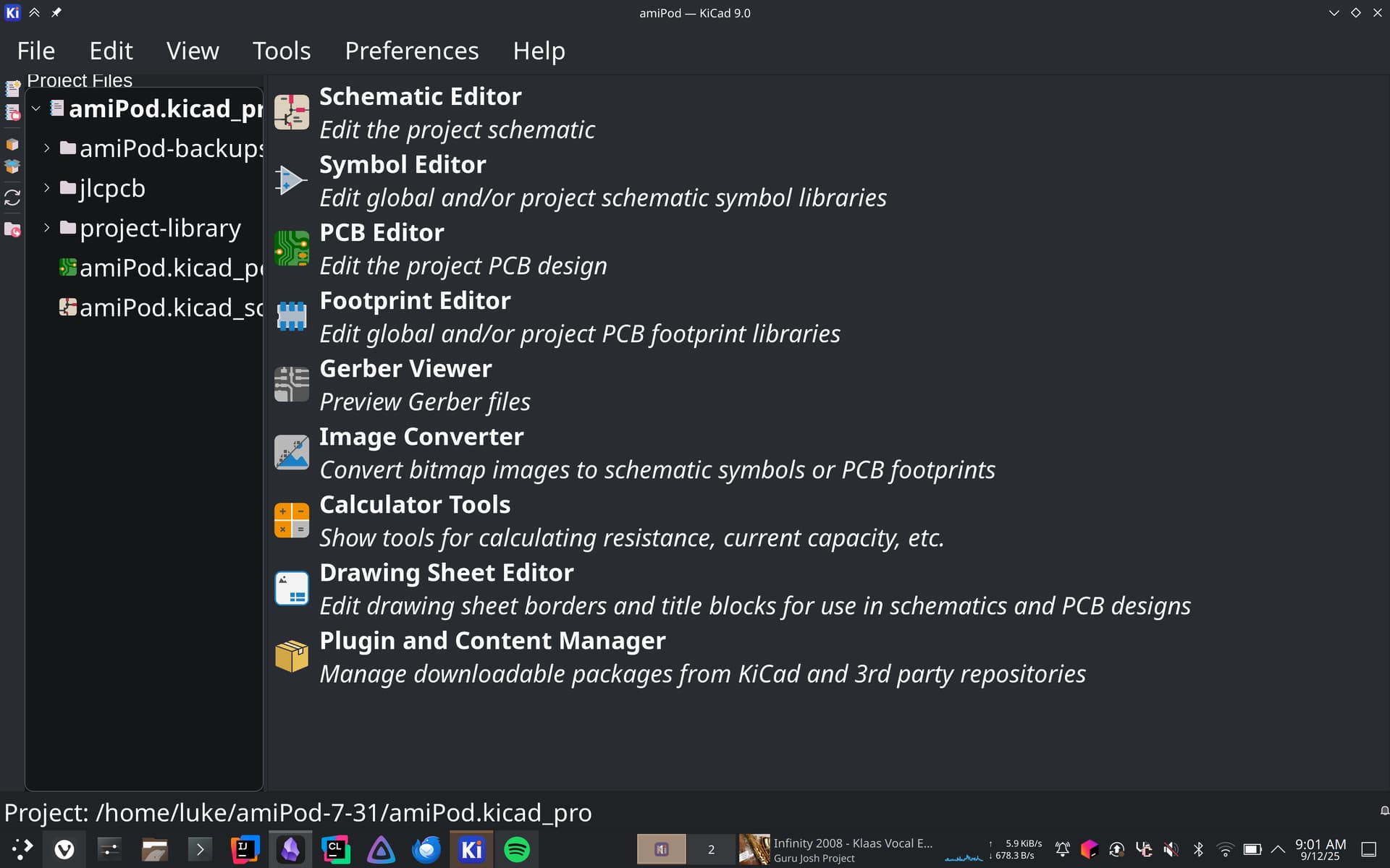

Linux hidpi problems
My gentoo laptop has a 4k display. These days, I don’t have many issues with hidpi scaling because of the advent of wayland and modern software libraries, but I occasionally still run into issues:
Does anyone have any advice on what I should do?

hI,
Unfortunately I have the same issue (gentoo and HiDPI here :frowning: )
Gentoo forces Kicad to build non-wayland support due to incompletness in wayland support in WX ( bug bug #911120)
but equally Xwayland support for HiDPI is shortcoming :frowning:
right now I do not scale the fonts as much
That bug is from 2023. I wonder if it would be worth it to open a new one to see if anything has changed in the past 2 years?
I talked to sam_ on IRC when 9.0.x was being released about the possiblity of enabling EGL. WX is still got issues, as recently proven in feb 2025
Add run-time check for EGL version on canvas creation · Issue #22325 · wxWidgets/wxWidgets
Wxwidgets / Kicad: High load with EGL support enabled · Issue #24977 · wxWidgets/wxWidgets
Likewise, Wayland still have limitations: KiCad and Wayland Support | KiCad
in short, its probably too premature to switch kicad to wayland on gentoo but the beauty of gentoo is you can do that locally
