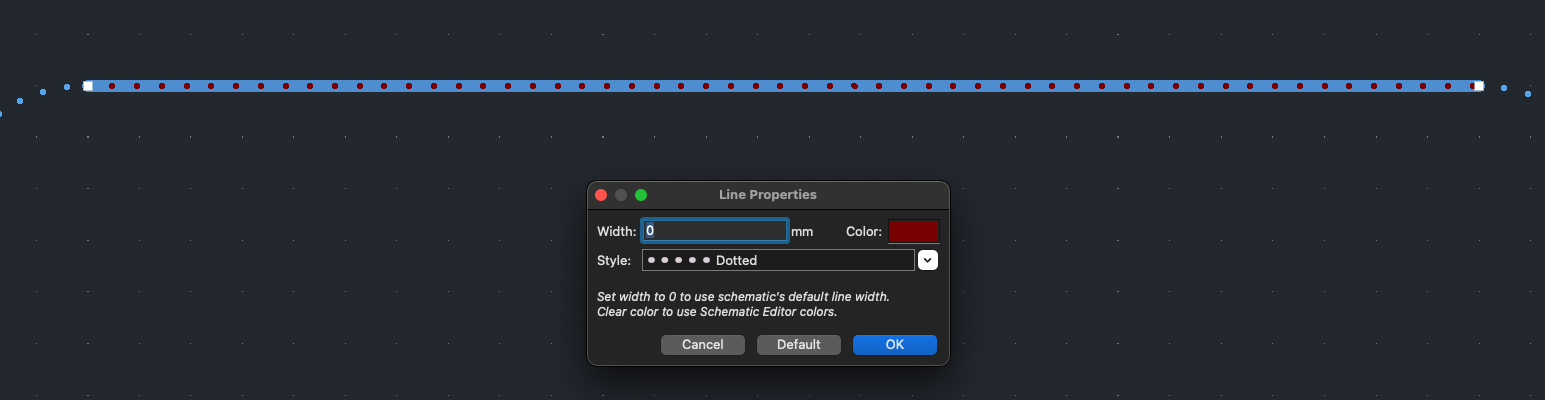

Seen below is a line and two corner arcs:
The left arc and the line are both colored red, despite the arc appearing blue:
The arc has a note which states:
Note: individual item colors overridden in Preferences.
The use of Preferences might be antiquated:
however, under Kicad --> Settings --> Schematic Editor --> Colors,
The category Schematic text & graphics matches the color, and in the top-right, Override individual item colors applies.
Override individual item colors can be deselected and then applied with OK, but it reverts immediately to selected, likely because this is a part of the wDark theme.
  • Why does this behavior only apply to arcs and not lines?
  • Is there a means, with the theme still applied, to manually color arcs and other shapes?
No, BUT
Preferences > Colors > New Theme > name your new theme then OK will give you a new theme that is both able to be modified AND will start with the theme you are already using.
ie. It will give you a modifiable version of “wDark”.

Mine changes.
Note: I’m using my “new theme” version of wDark so there is no overriding warning.
I’m also using a different OS… Linux Mint.
You’ve tried this in your New Theme?
No, rather I wondered if lines not being considered individual items was a bug.
There is something wrong somewhere.
No problem with personal version but the read-only has a problem.
I’m messing around with the Kicad classic (read only) to see if it differs also.
Yeah, looks like a bug.
This problem is only in arcs, and only in the "wDark (Schematic-only)(read-only).
Kicad default & classic and the wDark (when copied to a personal scheme) are all OK.
