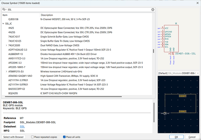

Hi, I have checked all the filenames, paths in the Schematic editor, and symbol editor and the main page. All looks correct.
I am getting a strange results.
If I open a project from version 7 it all opens fine.
In version 8 I then choose a part on the schematic and edit the library symbol ( not the local one ).
All the parts in the library are displayed.
If I search for another part then OK,
BUT, when I search in the lib I have just looked in I only get three parts listed.
So sometimes I get all the parts then others I get only three. I have checked the lib file with notepad++ and the structure looks OK and all the parts are in the file. I did not save the lib file from notepad++ as this could change things and I do not want to add anymore variables.
Here are the screenshots.
This is using add part button in the schematic editor.
next screenshot of using edit symbol

As I mentioned before, when you have text in the search string, it only shows symbols which have that string in their properties or keywords.
Can you show a screenshot of the Choose Symbol dialog after removing that search string and then scrolling down to show the content of the SSL_IC Library?

Part shows up when no search string is used. I used add symbol button in the Schematic editor,
After experimenting a bit more. It does look like the search is the thing that has changed. Before in version 7 I could type SSL to take me to my libs and the parts would be listed. But if I now just scroll down and find them all the parts a visible.
The interesting thing is that the term SSL is not in the part text and has never been so. So why would this only show three parts.
From all I can see this is simply as designed. When you search for things, then all the other things that do not conform to the search string not shown.

Note that it also shows symbols that do not have the search string in their name, but also symbols which have this (sub) string in their description or keywords fields.
Many thanks. At least I can use version 8 now.
Just for information this is Version 7 screenshot with SSL search. It finds the lib with SSL and lists the parts.
