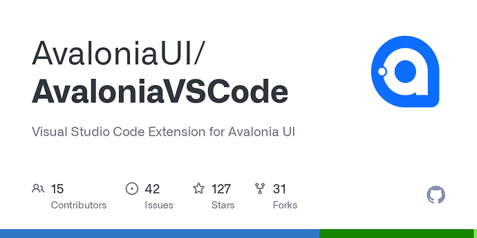

Avalonia has a VSCode extension for WYSWIG
