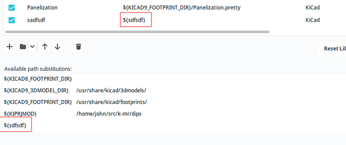

You are missing the entries in the library table itself. You can add them in the Preferences -> Manage Footprint Libraries dialog, or if there are lots of them, copy your custom libraries from ~/.config/kicad/8.0/fp-lib-table to ~/.config/kicad/9.0/fp-lib-table (or the platform equivalent). They are probably at the end.
‘manage symbol libraries’ the path substitution field does not show the 3rd party path
This area shows variables used in the table, which won’t include your 3rd party library path if no libraries using it are in the table. For example ${sdfsdf} isn’t defined in the paths list, but it is used in a table entry, and ${KICAD9_SYMBOL_DIR is defined in the paths configuration, but is obviously not used in the footprint table, so it doesn’t appear:
