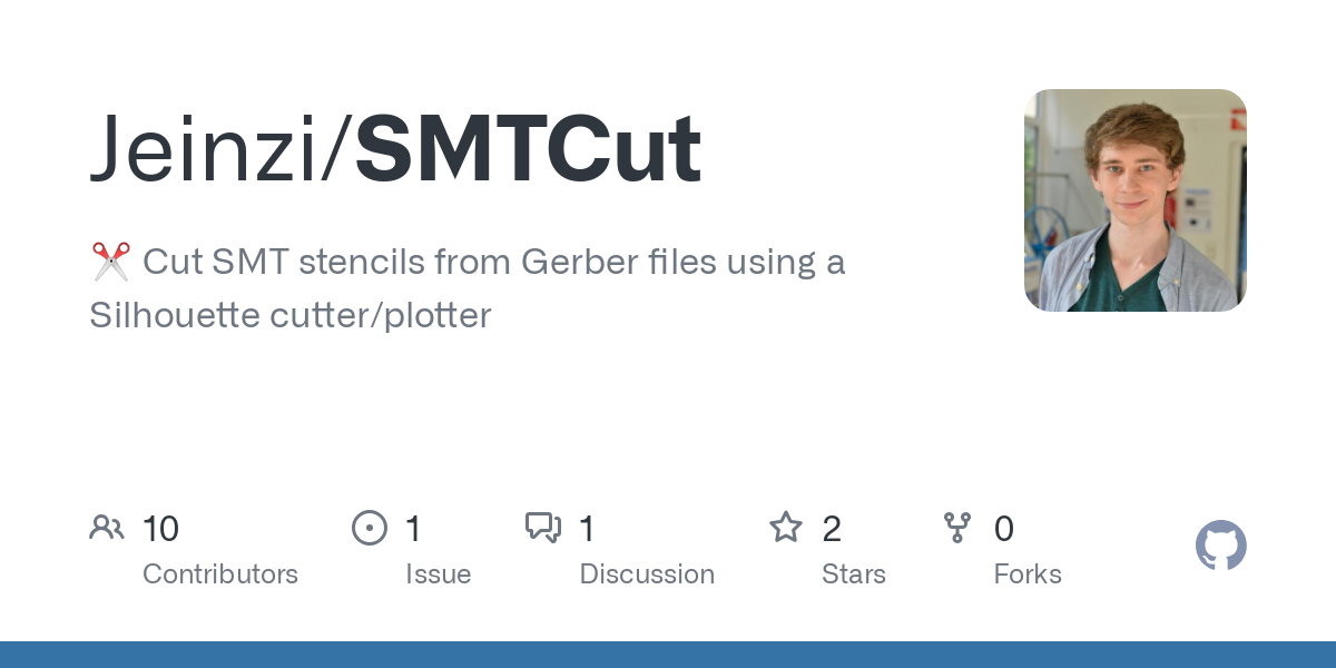

I cut on a plotter up to 0402 everything works out well I use film for regular printers 100 microns. You can cut directly from Gerber avoiding conversion to vector formats
