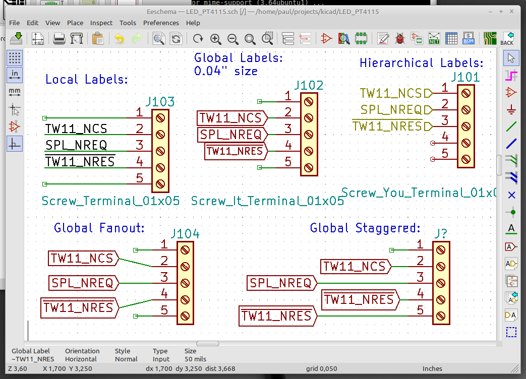

What about decreasing the label size to 0.040 or less?
I’ve never liked the box around the global labels much.
I do appreciate they made a the box a bit bigger to accept inverted text but that indeed makes it overlap with other nearby labels.
In the screenshot below I’ve made an overview of some possibilities.
Making the text itself smaller as pedro suggests works, I did this in the 0.04" size example.
I do not particularly like those two options. Text is of course perfectly readable when zoomed in enough (and it’s searchable, highlight tool, etc) but when zooming out KiCad (still) has some issues in keeping text readable. Even on the screenshot below text is already unreadable (on my normally 0.24mm pitched monitor)
I do not see your option (Keeping same box & font size, but shifting the text) as a good option. You also have to consider schematics get printed on paper, low res pictures are made as screengrabs and used as documentation, shared on forums and lots of other uses. Your inverting bar is visible, but just barely and it’s hard to distinguish from the box itself. You really need a decent amount of space between the box and the inverting bar or else it all just gets to crowded. It is the combination of the box around the whole label combined with the inverting bar itself that just does not work very well.
Both the local labels and the Hierarchical labels do not have this box problem and are perfectly distinguishable in the last screenshot below.
Two other options are the “Global Fanout” which works relatively nice for up to around 10 labels and is also quite easy.
“Global Staggered” can be made in any height, but needs more paper.
On top of that. A global label here and there is a good tool for the toolbox, but making lots of connections with long rows of global labels is a bad practice in itself. In KiCad-nightly V5.99 the capabilities of buses are extended considerably, and you can use local labels, put them in a named bus and route that bus to other sheets.
I just tried, and yes, it’s an option.

Thanks for this exhaustive review of the different methods.
I tried setting the label to 0.9mm which sounds a good option. Anyway, I never print my schematics, so they are all zoomable. Beside this, printing a 484 pin FPGA on a A4 wouldn’t result in a very informative document. And I may even use more pins in the future. It would be good to have the possibility to automatically resize the inverted signals so that they don’t overlap, just as in your screen copy. You apparently resized only ~TW11_NRES.
Local labels are not an option because I never know what line it applies to. Well, that may be only me… I know, it’s the closest one, but I’ve seen case where it’s not obvious. And especially if they are inverted, it’s not easy to judge which one is the closest one.
