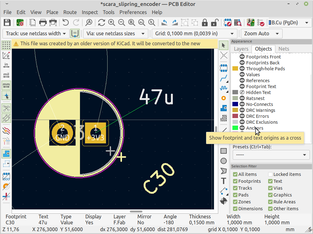

In the past when I moved a part label I recall seeing a blue line connecting to the part so i could track the move. I don’t see the line anymore and in tight situations this is important for keeping parts with their label.
Looking at “view” and a few other places I don’t see how to re-establish the line.

  2. By label I am referring to the 'Reference Designators" for a component- Thus for a resistor one would see “R5” etc.
  3. Thus retiredfeline’s life will NOT be ruined. (But cats never retire from pestiing!)
Thus-for example-in the past if I placed my cursor on the “R5” and typed “m” this silkscreen reference would be movable but a little dark blue line would appear connecting the reference to the center of the actual resistor component. Sounds trivial but it is actually quite important to insure I don’t mix up references on a crowded board. My blue lines are gone–I figured this is an option somewhere but I could not find it.

In the mean time I’ve been searching through the menu’s, and I did not find a way turn these on or off, but I did find a way to set their color with:
PCB Editor / Preferences / Preferences / PCB Editor / Colors / Anchors
Then I also saw the “Anchors” in the Appearance Manager
According to the tooltip (dis-)ables a cross at the text origin, but if you change the color (double click on the colored rectangle), then you can also set the color of the line. I set them here to bright green.

Bingo.
I went into the preferences manager and changed colour to a bright blue and now I see the lines. I think the problem is that they are very thin and the original dark blue was not visible on my screen (I often work in my from a laptop sitting next to my cat). So this fixed the problem and I thank you.
