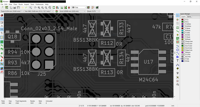

Making assembly drawing is a little more complicated. I add to footprint simple field “X”. When
i want to mark component as not fitted i just change visibilty of this field and plot fabrication
output.

For now ,for every PCB variant, i manually mark if some parts are not fitted
and actually i don’t have idea how to deal with value variants.

In Variant A Q11 schould be marked as DNF in assembly and removed form BOM and P&P.
In variant Production Q11 should have changed fields value and Part Number.

  • script to change Assembly drawing - i think it is most dificult. I think there are two solutions.
    Firs change visibility of field “X” to mark DNF or use additional layer (two for each side of PCB)
    to draw lines on footprint position. Change value schouldn’t be a problem.
