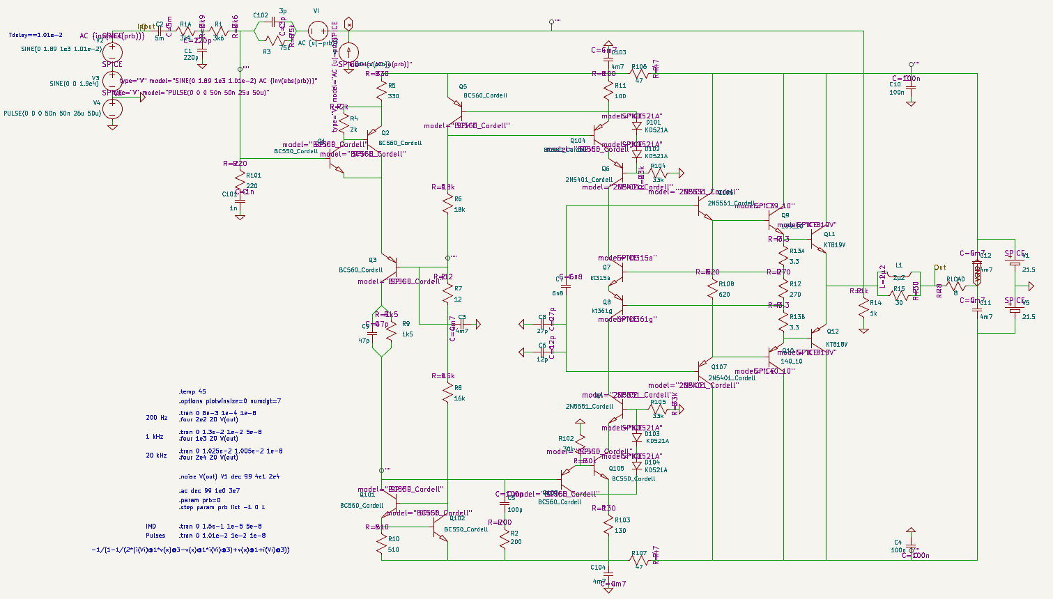

078-RIAA_MM-MI_75usLR.asc is in “UTF-16 LE” encoding instead of the expected UTF-8. How did you create this file?
Акулиничев_1989-10-56~58_tweaked.asc import works:

LTspice uses UTF-16 LE format (without a byte order mark) for what it calls Unicode support, for any file that contains a character that cannot be represented by the system’s 8-bit extended ASCII code page.
This file contains some Cyrillic characters (see line 619 and 6120) so it is saved as UTF-16 LE.
If all characters can be saved using the extended ASCII encoding then that 8-bit UTF-8 compatible format is used instead. LTspice does not use UTF-8 encoding.
