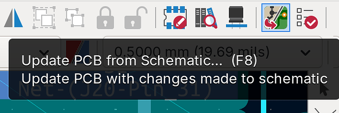

Is there a way to do what this button does but in the opposite direction? I.e., update schematic from PCB.

No, but Pin / gate swapping is on the roadmap (ignore this)
Yes . . .
but I’m not certain it will do exactly what you are looking for it to do, try it and see.
oh, then ignore my comment, I misunderstood the question!
Nice, that is the button. Now, how do I see the new connections in the schematic file? There is not ratsnet or alike.
As I said, it might not do what you are looking for, test it and see.
