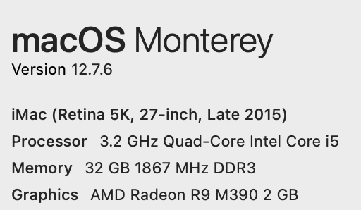

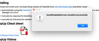

I’m on OSX 12.7.6
When I last updated Macros, Kicad was removed from the list of Installed macro/wb.
I hadn’t noticed it (haven’t used Stepup in a few weeks).
Upon seeing this post, I now noticed it was no longer installed. So, I listed all Macros and Installed it the usual way (clicking Install)… It worked and no problem(yet…)
ADDED:
I’m using FreeCAD 1.0.1 Rev 39285 (Git)
