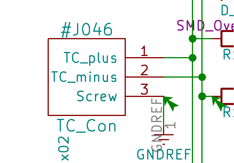

KICAD replaces Reference with #J046 and does not export it to the netlist
I’ve got a problem that KiCAD rplaces my Reference J100 with #J046 when executing an ERC or export to the netlist. I do not know what the problem is, nor how it can be resolved.

Is there another J100? A text editor search of the netlist file is worth trying
References starting with ‘#’ are ignored by the netlist export. This is kicads way of implementing virtual components like power symbols.
Edit the symbol properties in the Component Editor and un-select “Define as Power Symbol”.
As Davidsrsb suggested, you can try directly editing your schematic (and/or project-cache.lib) in a text editor.
It also seems to be a custom symbol.
What happens if you remove it and replace it with (a different) default library symbol?
