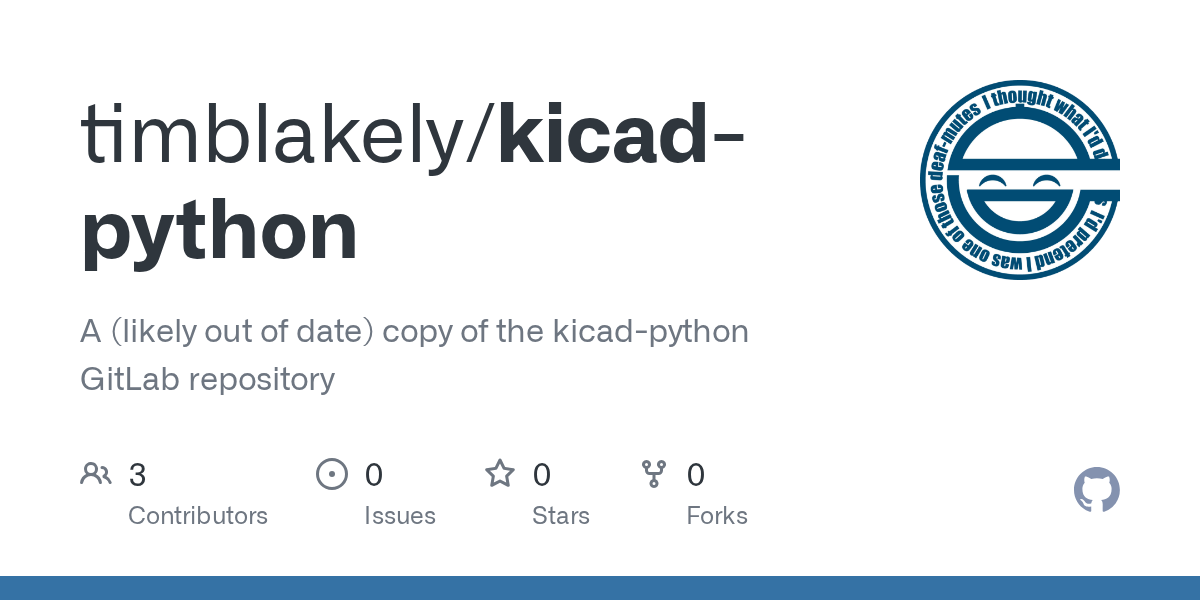

Now, inside the env, I see with “pip list”, that pip has kicad-python version 0.4.0.dev0
But I cannot “import kipy”
ModuleNotFoundError: No module named ‘kipy.proto.common.envelope_pb2’
What am I doing wrong here?
Thanks
P
Why are you using someone’s random out of date copy of the repo instead of the official repo?
You’re missing the build steps from COMPILING.md, probably

Thank you for the pointer, deleted previous, went to the gitlab repo, followed the COMPILING.md.
Needed to install poetry manually;
as the read me method resulted in poetry config invalid error.
But now my placement script is working.
