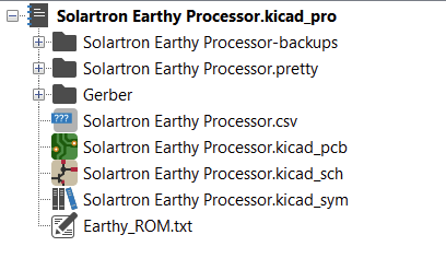

The Project Manager/File Browser doesn’t show all files in the directory for the project.
For example I’ve added two files relating to the necessary ROM image (Earthy_Rom.txt and Earthy_Rom.bin) but only the .txt file is shown. Similarly I added an Excel (.xls) file derived from the BOM .csv file. These simply aren’t shown, and I think they should be.
Am I missing a setting that will show all files in the project directory?
Thanks, David

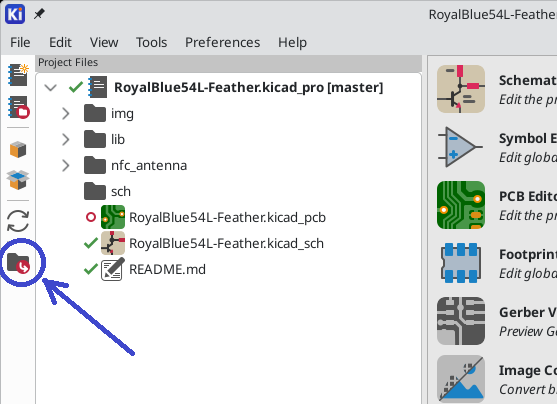

Sometimes, for example, I’ll have a bitmap image of a pcb that I’m going to include in documentation.
I just click on the icon to open a File Explorer to see all the files if I need to (indicated mid-left of screenshot above).

Meh. In the screenshot from TimC_Harris, it shows an README.md (Markdown), while for me it does not show *.adoc (AsciiDoc) and that is pure discrimination!
I know - that’s what I am complaining about.
