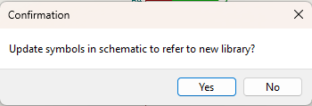

Assumming Footprint == Template == Pattern.
Here’s an overview of how to make your project portable:
1. Check project synchronization
Make sure your project is fully synchronized by running Update PCB from Schematic… once again:
2. Preparing footprints
If you’re using KiCad 9, you can embed 3D models in the footprints (although there’s no button to embed every 3D model automatically yet, and you have to close the dialog before the embedded file gets detected):
Otherwise, make sure you have relative 3D Model paths on your PCB, e.g. by running the Archive3DModels plugin.
3. Saving footprints
Use Export → Footprints to New Library… to save your footprints:
Choose Project:
Choose Yes:
4. Updating schematic
Use Tools → Update Schematic from PCB… menu item:
Click Update Schematic:
5. Saving symbols
Use Export → Symbols to New Library…
Choose Yes:
Choose Project:
Choose Yes:
6. Check
7. Save the PCB and Schematic
