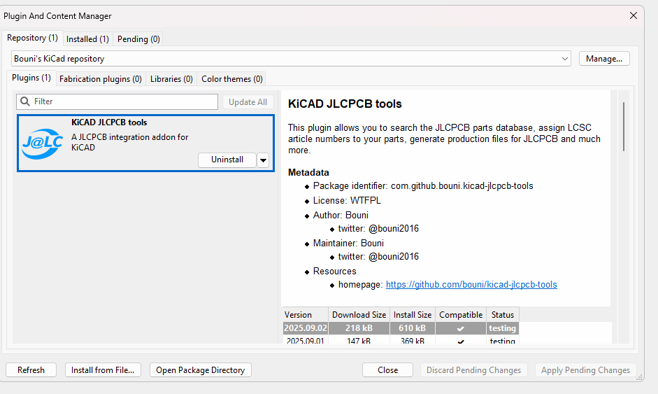

Kicad Plugin not showing

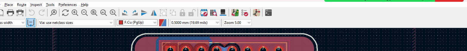

I’m trying to install the JLCPCB PCB assembly plugin for KiCad. After adding the repo and installing it, the plugin doesn’t show up in the PCB editor or under Preferences.
This happened to me before, and reinstalling Windows fixed it that time — but I tried reinstalling Windows again today, and it didn’t help. The plugin worked fine in older versions of KiCad, but after updating to 9.0.6, it just doesn’t appear anymore.

I’ve had this plugin installed before. Updated KiCad today to 9.0.6 and it appears fine and works as intended. On this machine I’m on Win11.

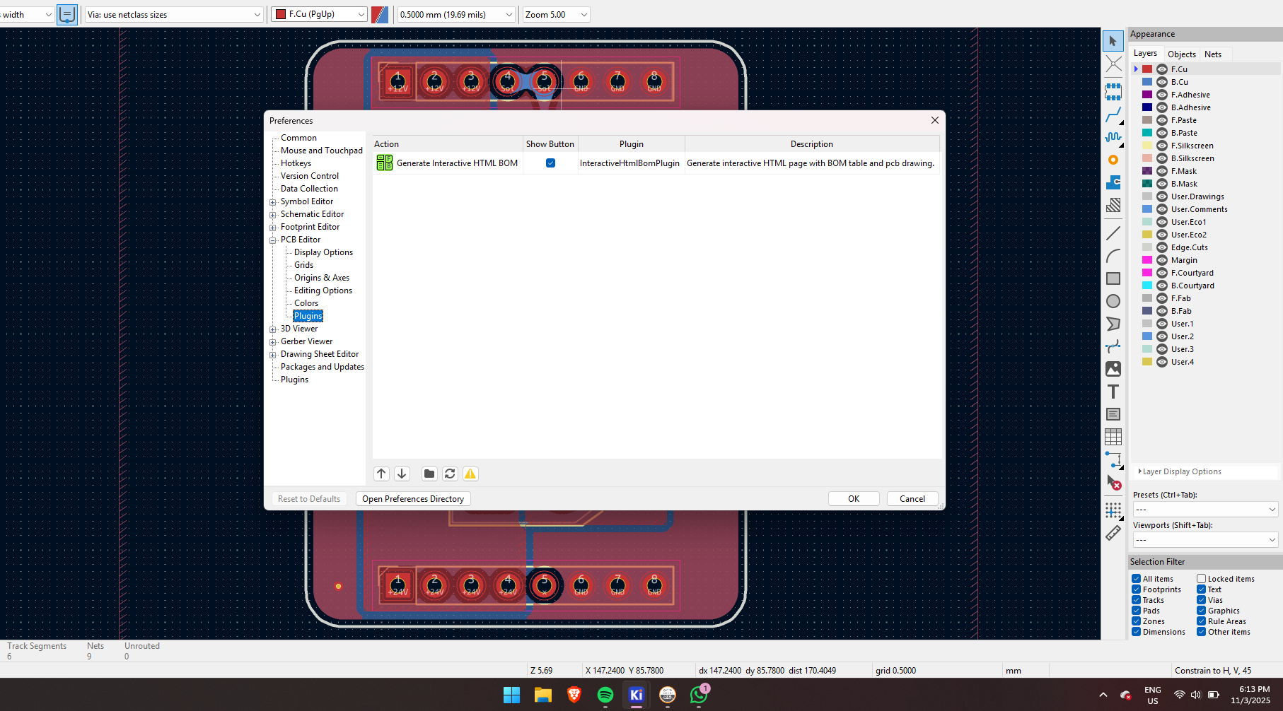

On your first screenshot there is a yellow exclamation mark button in the dialog. Click it and copy the text here, it will explain why some plugins are not loading. Most likely there is some unsatisfied dependency.
File “C:\Program Files\KiCad\9.0\bin\Lib\importlib_init_.py”, line 126, in import_module

import requests # pylint: disable=import-error
ModuleNotFoundError: No module named ‘requests’
This is the error,hope this helps.
This is the issue, you are missing requests library in your kicad installation.

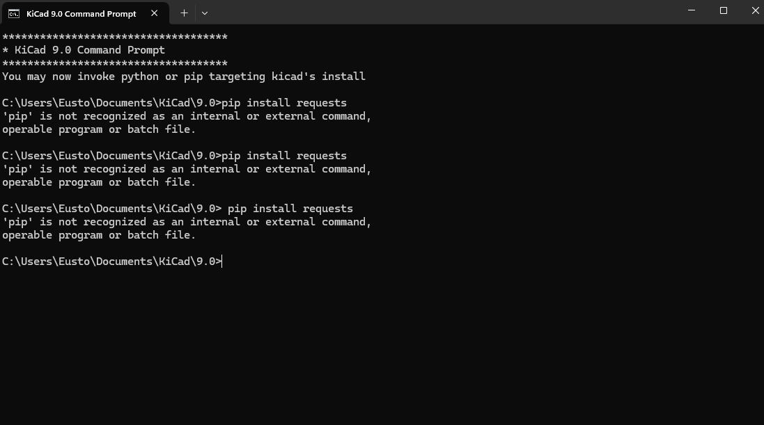

I attempted it twice and it says pip is not recognised, how do i install pip. Thanks
You should not have to install it yourself, it installs with kicad. Try reinstalling kicad.

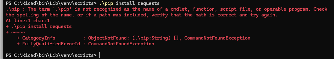

I tried opening with terminal but it returned with this error
and when i tried using cmd from the file explorer it returned this.
C:\Kicad\bin\Lib\venv\scripts>.\pip install requests
‘.\pip’ is not recognized as an internal or external command,
operable program or batch file.
(I am limited by Kicad embeded messages as i am a new user so unable to upload image)
I don’t know but might it be caused from the difference in like the path because the path of my scripts is :C:\Kicad\bin\Lib\venv\scripts
Yes, that is wrong path. It should be bin\Scripts, without Lib\venv

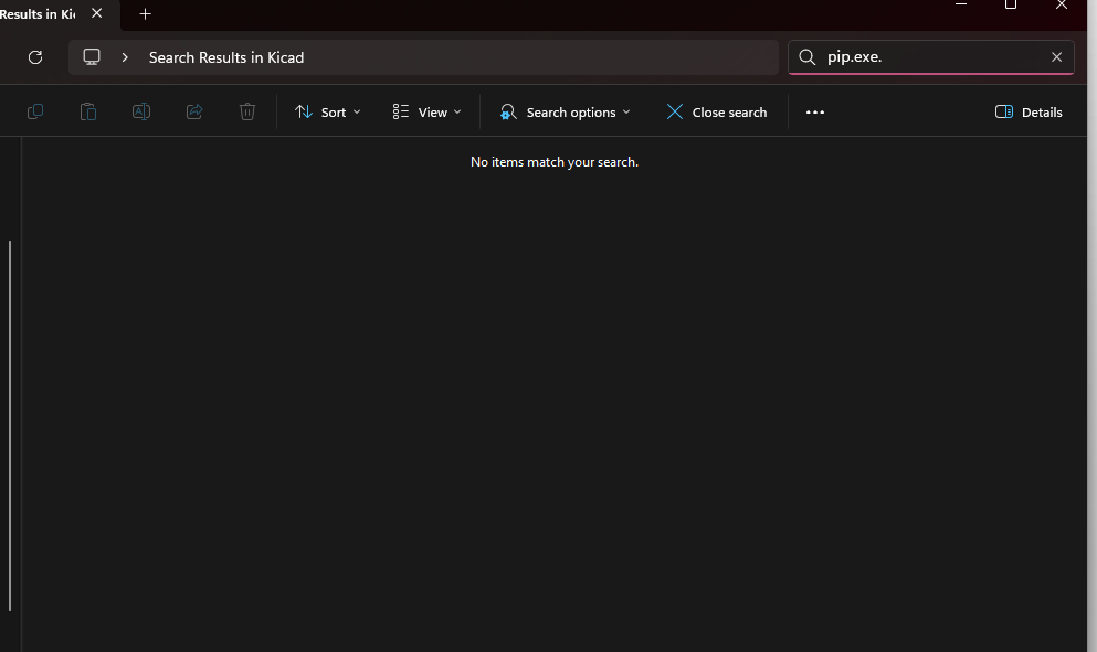

Look around in your kicad install directory and find pip.exe.
I do not seem to have the pip.exe in my Kicad folder.

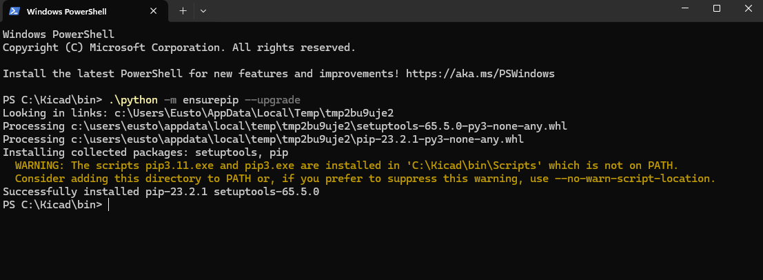

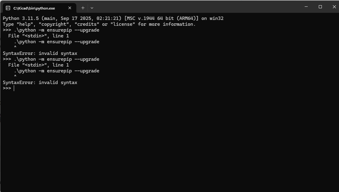

Strange, kicad should have installed it. Well then find where python.exe is in kicad (should be in bin), open powershell there and run
.\python -m ensurepip --upgrade
then you should have pip.exe
Apparently that is invalid syntax.
It’s not a python command, it’s a shell command. Like I said, open powershell in the folder where python executable is, run the command in powershell.
Did you mean the folder which contains python.exe?
For me ,Python.exe was in my bin folder and i copied ad paste what you sent and this happened, is this correct?
Hi , i finally managed to fix this error, after following your instructions and doing the above, i went to my kicad command prompt and typed pip3 install requests which managed to fix my error and allowed me to use the plugin. Thank You so much for your help!
