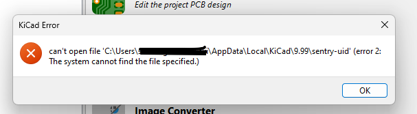

OK, I installed 1876 and received this Error/Dialogue box . . .
other than that it runs and opens projects . . . I didn’t import my settings and I did do a full install with 1GB + download
Ok. Thanks for your effort. I don’t have a full install either and I didn’t get that message.

I checked:it throws a win exception 0xc0000374
meaning stack corruption. So that’s severe…

Woops I should fix that (I moved around a whole bunch of code 3 weeks ago that would cause that)
