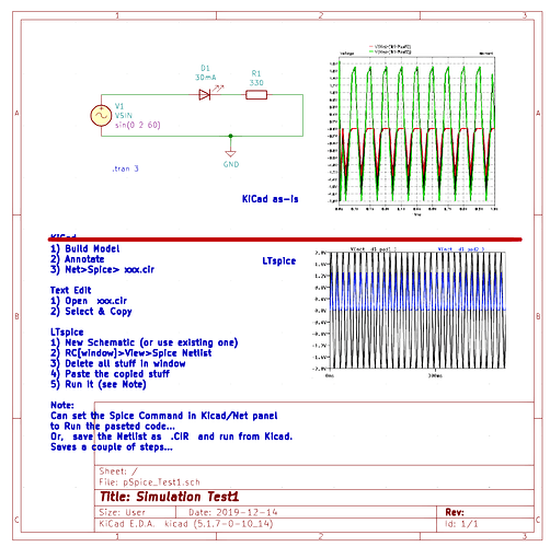

I’m just learning Spice and Kicad NGSpice. Please check my simple DC Amplifier Circuit using a 741 OpAmp.
The simulation seems to be working but I’ve got some questions as I’m low on the learning curve and just feeling my way along right now …

Question 3 - I’ve attached an image of the schematic and 741’s Spice Model Editor …
Do things look correct? Did I populate the Spice Model Dialog correctly?
Question 4 - I didn’t see a Integrated Circuit “Type” so I chose “Subcircuit” as opposed to “Code Model”
Was that the right choice? And for future reference how would I know which one to pic? For instane if the model were a partname.mod file or whatever.
