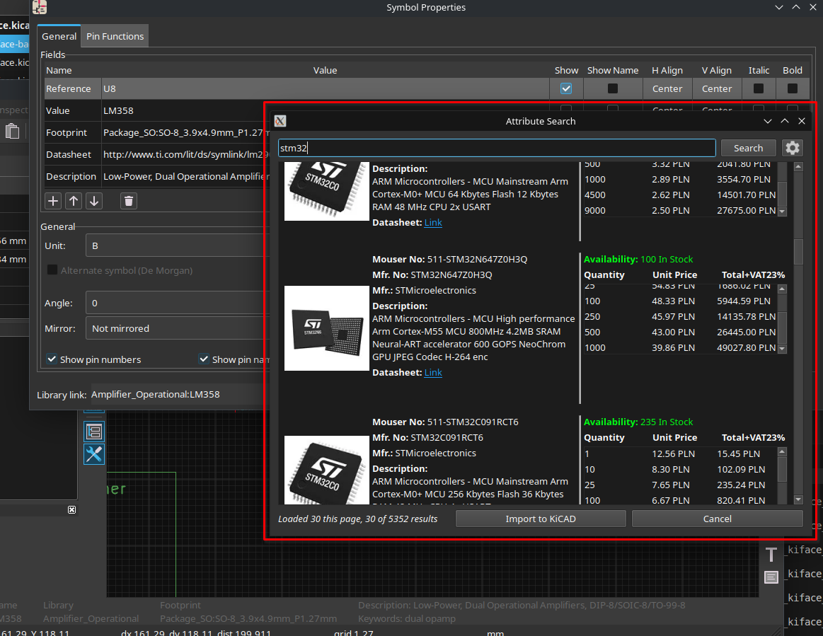

I want to create a plugin for the KiCAD EESchema editor that would allow opening an integrated store (like Mouser or Digi-Key, LCSC & etc.) directly inside the program, searching for a component there, and importing its Name, Datasheet, Description, Mfr. No., and Manufacturer into the Symbol Fields. That way, the only remaining step would be to generate a BOM file and place an order.

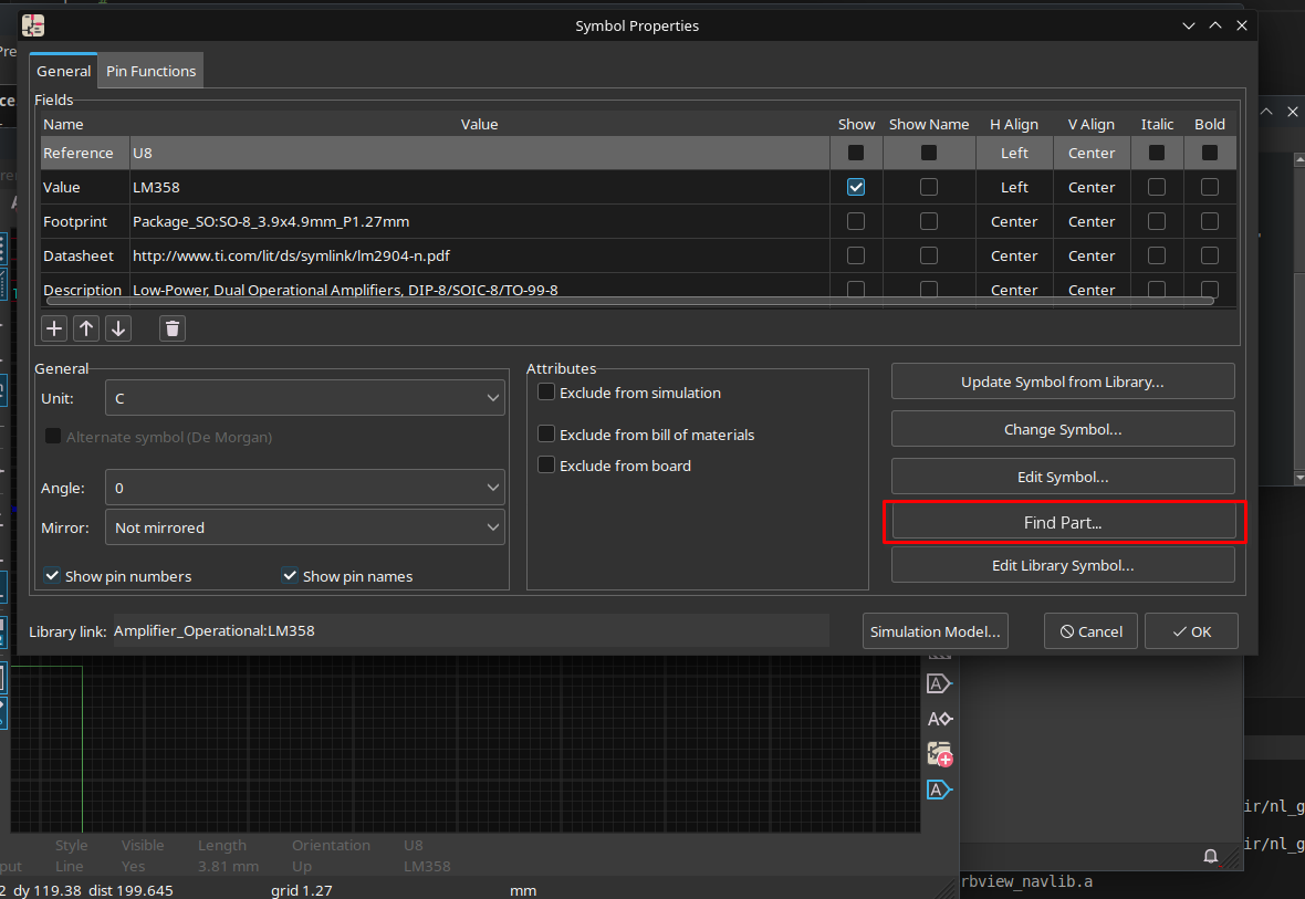

I found the file kicad-source-mirror/eeschema/dialogs/dialog_symbol_properties.cpp, and as far as I understand, this is the file responsible for rendering the window where I need to add one button and a function that would receive the exported Attribute Search values of the selected component from my program.

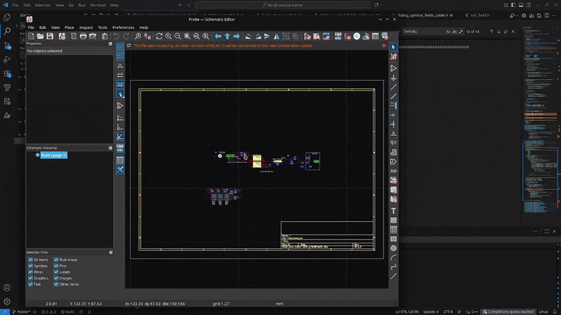

However, I can’t compile it, because as soon as I include a single header file through CMake, a bunch of other dependencies show up, and some header files are also missing, which only exist during the full project build. In the end, I realized that I need to compile the entire project — but the problem is that it takes a very long time.
Does anyone have an idea how to make a test dialog window (dialog_symbol_properties) so that it can be debugged easily, and eventually, once everything is ready, I could just copy the code into the full KiCAD project?

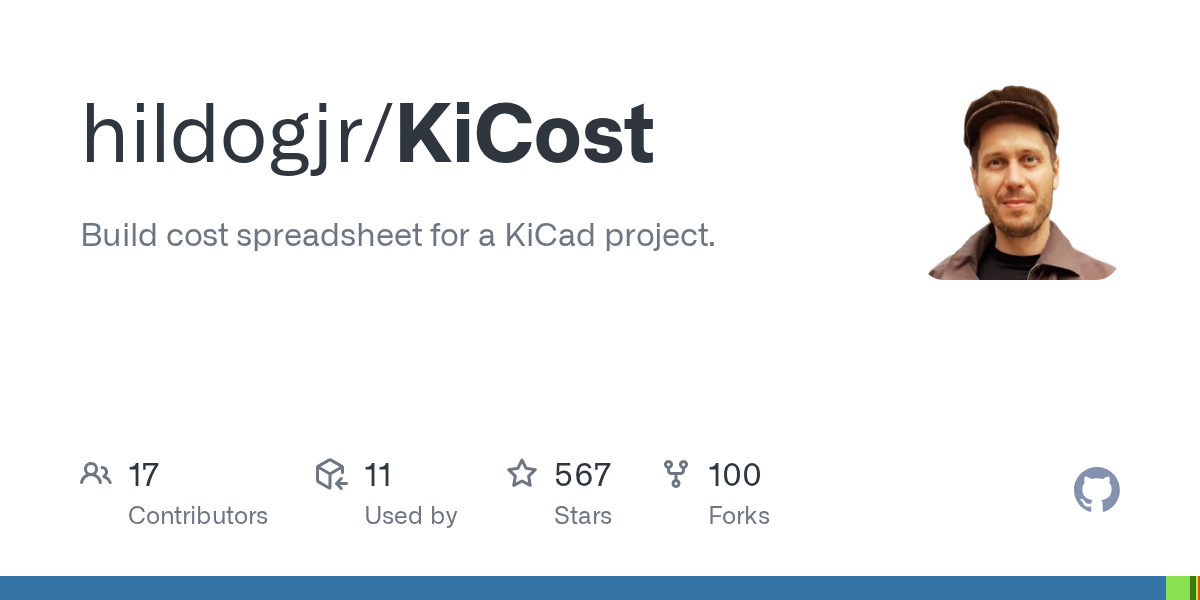

Are you aware of KiCost?
It is/was a plugin (or standalone script?) that could pull cost and other data from various sources. As far as I know the manufacturers use various methods to block such automated approaches. I never used it myself, but maybe it’s useful for you to have a look at that source code.
Edit: I assumed that just mentioning the magic name was enough of a hint to start a search such as:
https://forum.kicad.info/search?q=KiCost
And finding things like:
I think it was @devbisme that started KiCost and stopped when they started demanding accounts/keys/whatever to do this? I think someone picked it up but I’m not sure.
