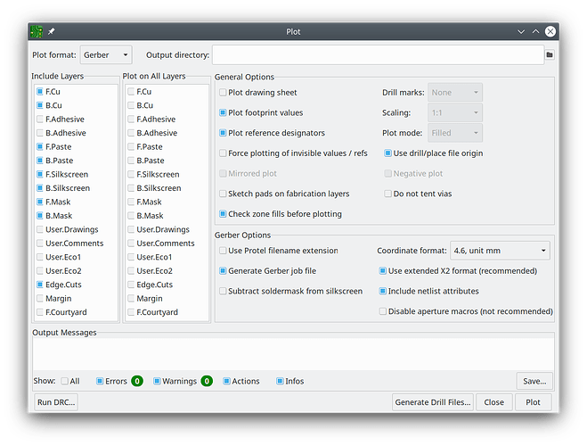

Unfortunately, the Plot menu has its own configuration checkbox “Use drill/place file origin”:

What is the definiton of “everything” in this context? There is (can be) a difference between the coordinates used in the PCB editor, and in the gerber output.
But if you want to make everything consistent, then this combination should work:
  1. Place your whole PCB in side the paper size.
  2. PCB Editor / Place / Drill/File Origin and put it both to the left and below the PCB.
  3. PCB Editor / Preferences / Preferences / PCB Editor / Origins & Axes with:
    • Display Origin → Drill/place file origin.
    • X Axis → Increases right.
    • Y Axis → Increases up.
  4. PCB Editor / File / Fabrication Outputs / (Plot format: Gerber) / General Options / Use drill/place file origin.
  5. PCB Editor / File / Fabrication Outputs / [Generate Drill Files] / Drill Origin / Drill/place file origin (This seems to change automatically to keep in sync with the step 4.

Thanks! I have followed your instructions, and if I view the created Gerber file in Gerber viewer, the whole pcb still has a coordinate with negative y and postive x, but according to the .pos file everything has a positive x and y, which one should trust ?
You skipped this part:
  1. PCB Editor / Preferences / Preferences / PCB Editor / Origins & Axes with:
