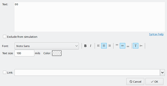

As I have an interest in fonts, I looked into how the variant form of 0 is represented in fonts that have it.
Slashed zero - Wikipedia
It seems one should enter a normal 0 then follow it by the variant form selector. So the sequence is 0030 FE00, or in Unicode representation: ‘0\uFE00’. When this sequence is displayed in a font without the variant form, it just shows the normal 0.
Using the Linux echo command, we can generate the sequence with echo '0\uFE00' which gives on the terminal:
$ echo -e '0\uFE00'
0︀
Running this through hexdump shows that the UTF-8 encoding is:
00000000  30 ef b8 80 0a                                    |0....|

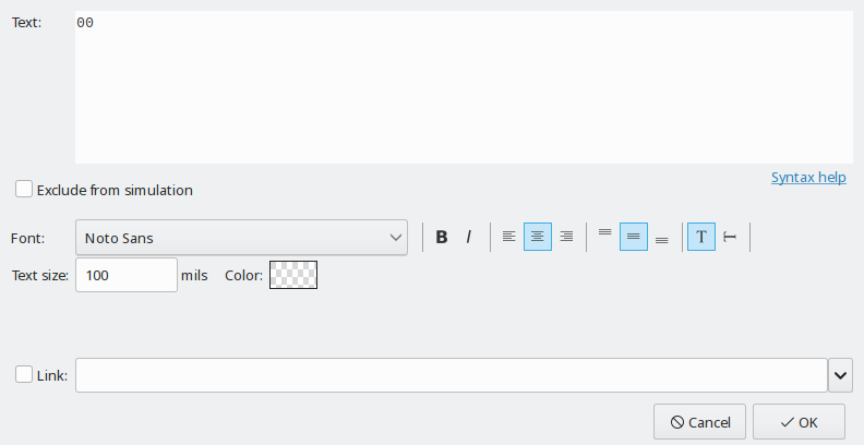

The 0a is the line feed. Now we copy and paste it after a normal 0 into the text entry box for text in a schematic:
Notice both 0s look the same in the text entry font. We get:
However this is in a font that has the variant form, Noto Sans.
So, to summarise, you need to:
  1. Select a font that has the variant form of 0, only a few do.
  2. Somehow enter the UTF-8 encoding of it into the text box; this is platform dependent.
As for the default KiCad font, I think that’s based on Hershey and compiled into the binary. I think it would be impossible to convince a dev to add a variant 0 to the font. So you’d have to use another font.

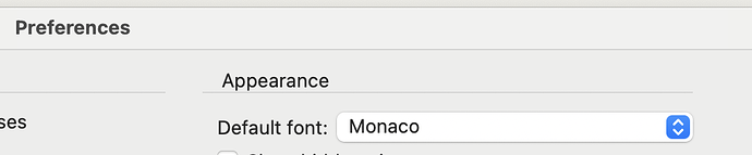

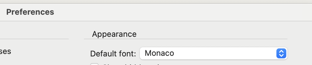

I think my method is slightly simpler
